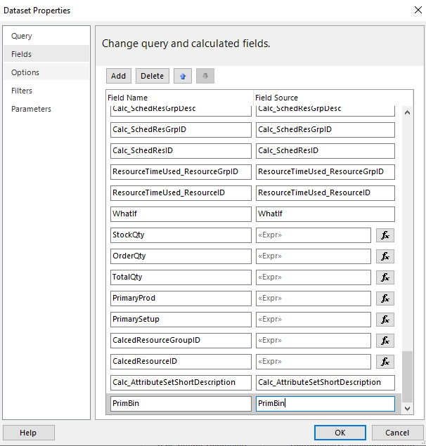

I noticed that in Microsoft Report Builder, it only has the JobHead dataset. When I look in Crystal Reports, it pulls all the datasets. Is there an issue in there?

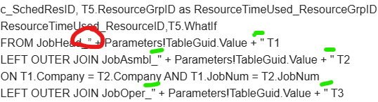

Okay… that looks better… I couldn’t tell, but just looking through your earlier post… the red “quotation marks” appeared to be “smart quotes” (curly) and not straight quotes (like the green ones).
The one (ones?)… set of quotes? sounds better, anyway… The set of quotes at the very beginning of the select statement also look like smart quotes.
But what you just pasted in looks consistent. Let me comb through.
That’s the only field that has brackets around it…could be something, could be nothing.
I am not sure why but pasting them here makes them weird quotes. I copy pasted from plain note pad. See attached.
I deleted the brackets.

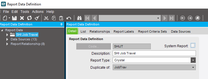

I think I figured out there is a different issue at hand here…
I peeled everything back.

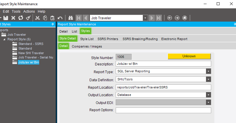

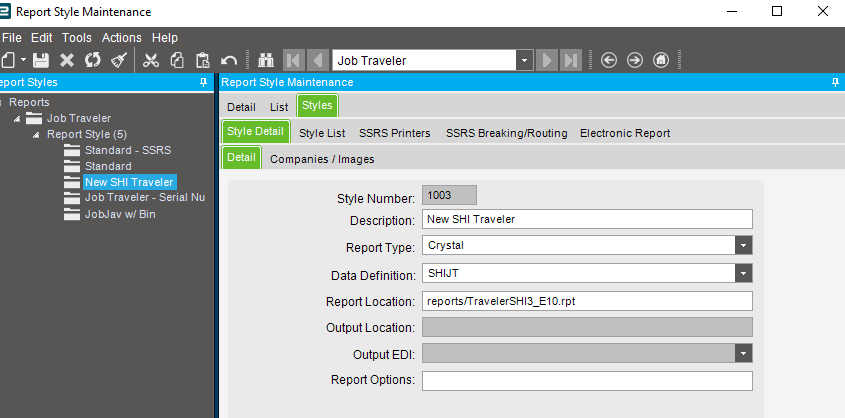

So the RDD I am using is a copy of an RDD that is for a Crystal Report. I copy it, change the name of the copy, and change it to SSRS.
So even without messing with the expression or dataset in the Microsoft Report Builder, this RDD gives me a SOAP error when I pair it up with the report file.

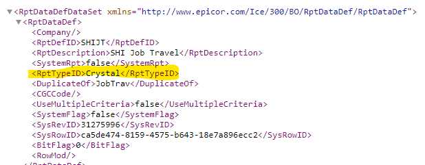

Well, I just started over from the beginning of this thread and at one point you pasted in your RDD… I just opened the xml and see this:
Could be an issue.
Change your RDD Report Type to “Base Definition”… see if that allows it to go through.
Found the real issue.
Nope… =(

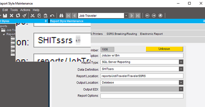

I tried changing it as you suggested and got the same SOAP error. Also tried changing it to base in the report style. Which made a “successful” entry in system monitor, but no report actually generated.

Rename your original report, and name this one the same as the old one and reupload.
Set your stuff back to SQL Server Reporting.
Run the report with this style and see if it completes and gives you a blank page.
