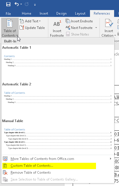

I think I might have a way. It’s not entirely automatic, it takes a bit of manual intervention.
  1. Add a DocumentMapLabel to fields that you’d want a TOC entry for.
  2. Print preview to Word
  3. When the Word doc opens, Insert a Custom TOC
  4. Click the the Options button
  5. Unselect the Outline Levels, and Select the Table entry fields checkboxes
  6. OK on the TOC Options and TOC dialogs
  7. Select the newly inserted TOC, right click and select Update Field
You’ll now have a TOC with page #'s that match the page that the field you set the DocumentMapLable for.
