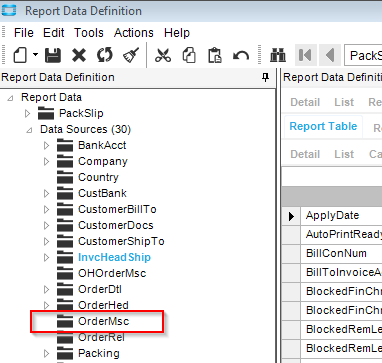

A modified version of an Epicor Supplied report, just the layout. No new fields needed, just moving some things around, or showing fields that are currently supplied, but not shown. For example, Adding text to bottom of the AR Form to show remittance info.
A modified version of an Epicor Supplied report, with new fields needed.
