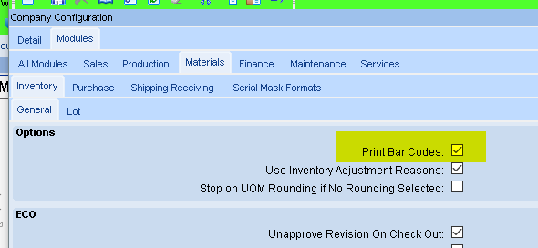

Print Bar Codes
The Print Bar Codes functionality is used in several modules to control whether bar codes can be printed on certain reports/forms. To print bar codes in the Epicor application, you must do the following:
  • You must select this Print Bar Codes check box here in the company Inventory Configuration.
  • You must install the Epicor Bar 39 font in the windows/fonts directory.
  • You must select the Bar Code option for the specific report you are printing.
  • You must be using Crystal Reports to print that report or form.
I just enabled it but it is still not showing in PDF. The standard Job Traveler report shows the barcodes correctly but it is in Crystal.

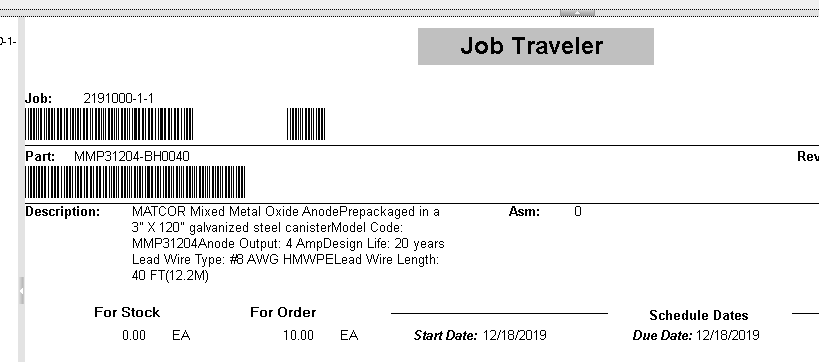

Previewing the Standard - SSRS Job Traveler with Barcodes enabled shows the fields, but not as barcodes:

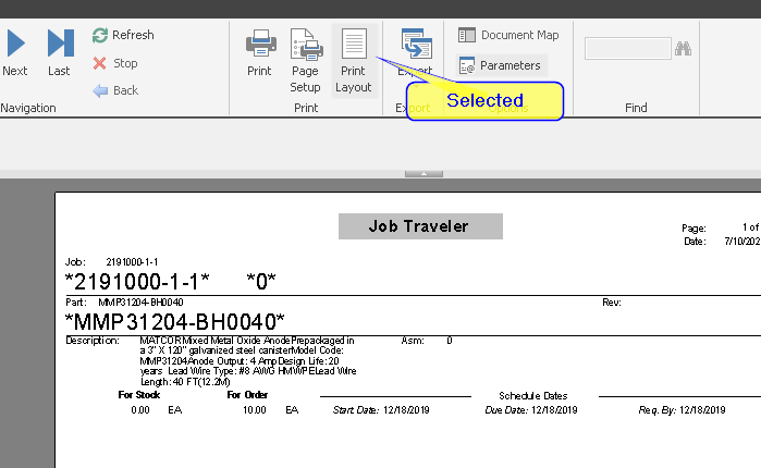

But when I switch Report Build to display in “Print Layout”, I get:
Try the following:

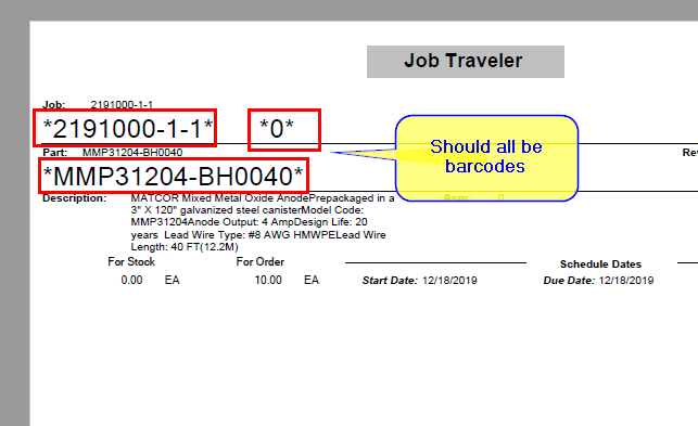

Yes, that is exactly what I am seeing too. Print Layout doesn’t displaying the barcodes and standard - SSRS doesn’t display it either like you are seeing.

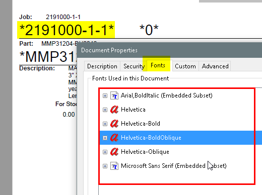

If I use the Export function in Report Builder to make a PDF, the resulting pdf doesn’t show the barcodes. And the PDF’s properties don’t list that font.

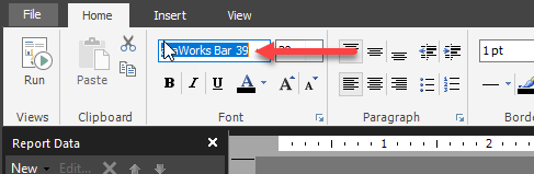

Try running report builder from the SSRS server. Make sure you can select the barcode font correctly when editing the SSRS report from the server. If you can’t select it from the server the font isn’t installed correctly on the server. Once the font is installed correctly on the server client computers that are not editing reports should not need it.
I tried it on the SSRS report server and locally on my PC where I am able to select the Dataworks Barcode 39 font. When running the report in report builder, it displays but when I select Print Layout, then it no longer displays

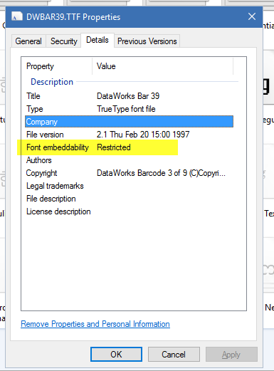

I wonder if this is the issue:
Maybe, but I’m not sure why I don’t have permissions to unrestrict it on my own PC. Have you tried it if it works for you?

The following is pure speculation on my part
I was assuming that the “Restritced” nature was something set by the font provider.
When doing a classical print (from any program) where the output is a piece of paper from a printer, the OS allows the print driver to render the barcode image it is to send to the printer. The font info is not required by the printer.
When creating a PDF, the PDF creation want’s to embed the font (any font, not just barcodes) in the PDF, for maximum flexibility. But since the font in question is not embeddable, the PDF only contains the text.
When the PDF is viewed, it substitutes one of the other embedded fonts.
