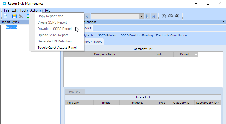

The down load is always greyed out
Is the Download greyed out when you click on an individual style?

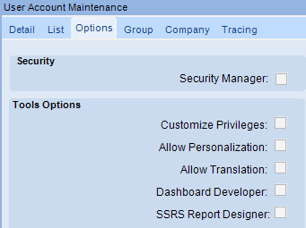

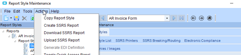

Oh, in 10.2.300+, there’s an option on User Account Security for SSRS Designers that needs to be turned on. That’s probably why you’re seeing the disabled Download item.
Thank you so much…I can download a report now
