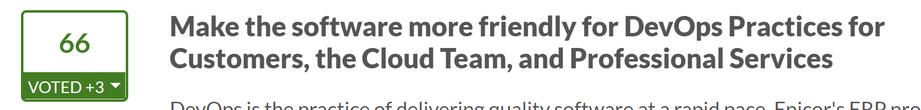

Make the software more friendly for DevOps | Epicor ERP Ideas (aha.io)
The problem is, what if one customization moves a control to the top right corner of a panel and adds a control to the top left, then another customization adds a control to the top right of the same panel thinking the other control is still in the original location? As much as it would be great to have different UI changes be associated with different solutions, I just don’t know how they would implement it.
Thank you sir, whoever posted that suggestion seems to have hit the nail on the head :slight_smile:
I’m no expert, but isn’t that a standard version control type problem? I think merge conflicts might be the right term. That is I don’t think this an Epicor problem, I think this is a general problem in software engineering that I believe has been solved.
