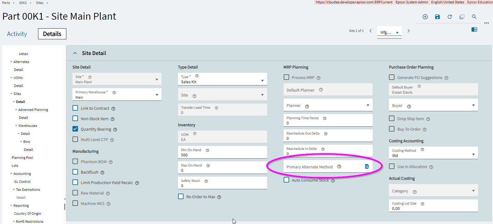

Tim I was trying to find the Primary Alternate Revision field and I am struggling.
Do you have a screenshot?

In the new browser based UI for 2022.2, it is found on the PLANNING card:
In the upcoming version 2023.1 the new and improved screen has it properly placed on the Site Detail card:
