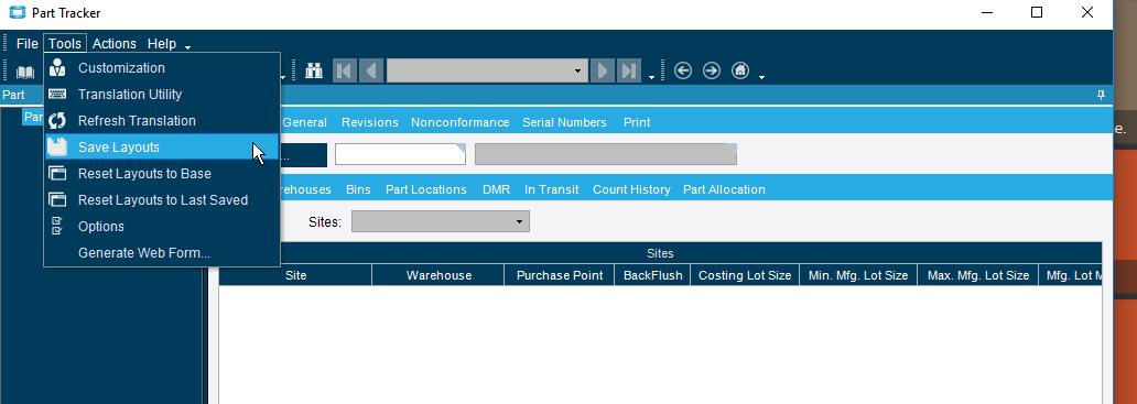

This is the menu that I was thinking out. However, the base layouts must only be in dashboards (I got mixed up I guess), not normal forms. This option shown below will for for personalization for sure, and maybe for customization. Get the layout the way you want, save the layout, then re-open the customization dialogue and save there again. It doesn’t always work, but I have gotten it to stick before.
