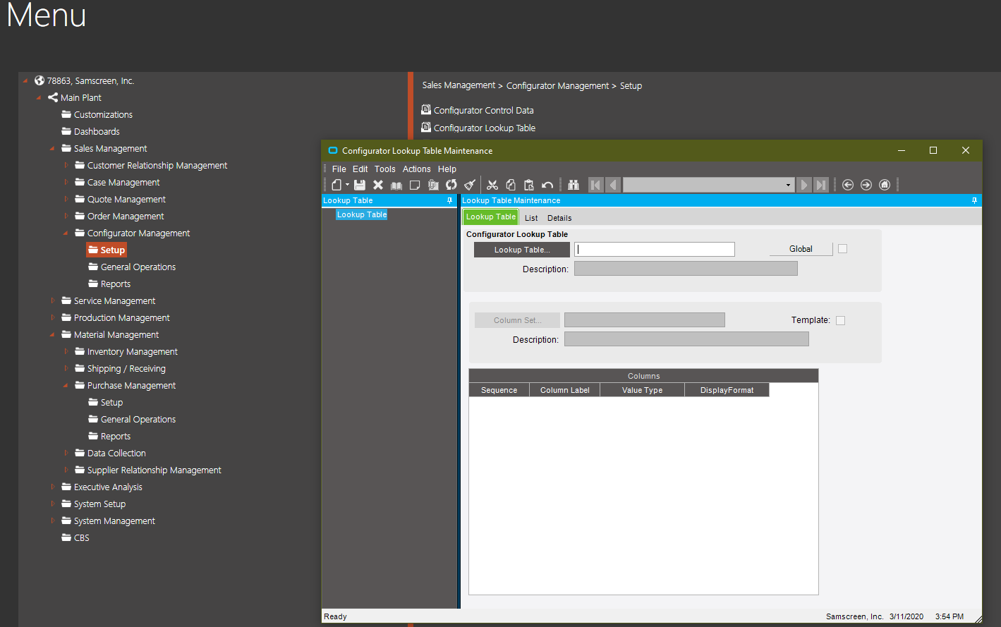

I’ve dabbled with that sheet, but each time I do, I get to the “column set”, and I have no idea what that is. I’ve been able to produce BAQs. So does the combo box to display BAQ results have to be a “BAQcombo”?

Lookup tables are a special epicor table that is designed to have flexible columns and rows… you can create your own “tableset” in the lookup table, and then populate that table with all the data necessary. Just think of each table in the lookup table as a separate spreadsheet, and you are fairly close… the only difference is that it is internal to Epicor.
There are pre-made lookup table functions that can be used to populate the combo boxes using the lookup tables. OR you can also write your own code (but this is not for the newby programmer). The lookup table format requires one new “join” for each column in the table, and can be rather daunting the first time. At Epicor Insights, in the Advanced class, I will a small code example for extracting the data.

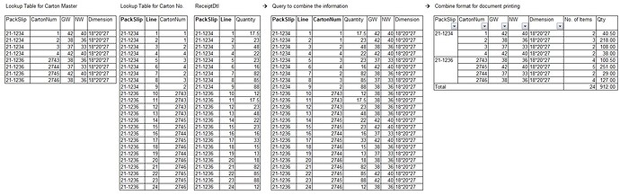

not sure if you understand my needs base on the upload pic. Thank you for your sharing.

i’d like to store those “lookup table” data in PC Lookup instead of using up UD tables.
How to write a query on the lookuptable?
How to set the dynamic list?
or you may show your own example.
