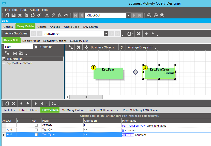

as @Banderson already said, it is not easily available… but I may have come up with a trick… it wont be 100% accurate, but may be ā€œclose enoughā€.
Create a BAQ that looks at PartTran… In that table there are two fields typically used for COSTING called PartTran.BeginQty and PartTran.AfterQty. These fields are not populated with every transaction… only those transactions that would change the cost (for average costing). this means that when ISSUING, the cost does not change, but when receiving materials, the cost could change… (ok… maybe I gave too much detail here)…
Anyway… you would not be able to find out how many times you ā€œstocked outā€ā€¦ BUT with this data, you CAN find out how many times you REFILLED inventory when you had nothing in stock …
To prove this i made a simple query that has the following filters:
  • PartTran.AfterQty > PartTran.BeginQty //finds all receipts that changed inventory
  • PartTran.TranQty <> 0 //This hides many of the non-inventory transactions
  • PartTran.TranType<>ā€˜ADJ-CST’ //this hides the simple cost adjustment transactions
