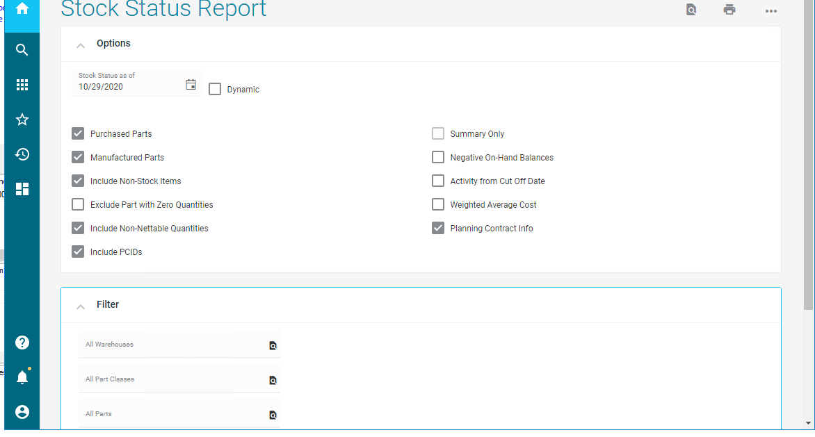

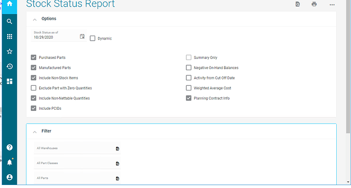

In my case I see OHQ on Part Tracker, Part Transaction History and even going to PartBin tables on SQL displays on hand quantity but no matter what option I select on the Stock Status Report I always get the “no records selected” error, this is only happening on one of the Plants.
All parts are Purchased, have positive balance, they are not Non-Stock items but I have even tried leaving that flag checked:
TranDate would affect Part Transaction History, is this correct?
Running total for current day displays OHQ, I am trying to run it to current date, not even past dated. I really believe this is a bug, I was just trying to workaround it.

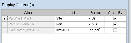

Make a simple BAQ to get the current QOH. You only need the PartPlant and PartBin tables.
  • Company = Company, PartNum = PartNum
  • Add a table criteria to PartPlant to limit it to the Site in question.
  • Show columns:
  • Expression for calc field : SUM(PartBin.OnhandQty)

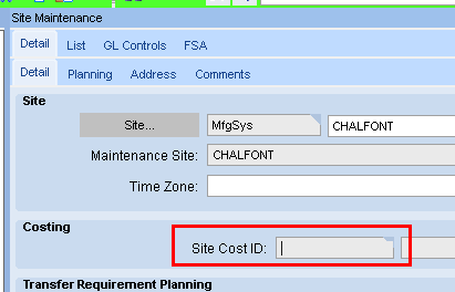

If that looks as expected, then look into the CostID used by the parts. Each site specifies a Site Cost ID to use. It is setup in Site Maintenance.
One odd thing I noticed on my setup, is that there is just the one Site Cost ID stup, and all sites - except our original one - use that Site Cost ID. The original site (MfgSys) has no Site Cost ID set.
But SSR works fine for us, so I don’t think that a missing Site CostID on the initial Site, is an issue (if you happen to see that too).
