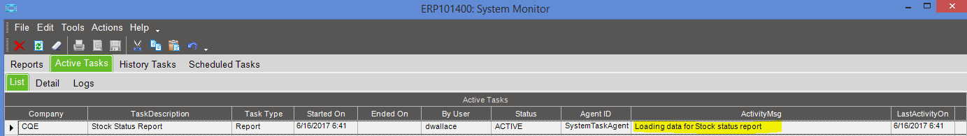

We are in EPICOR 10.1.400 and when we run the Stock Status Report it takes forever to get out and sometimes it does not even come out. It is active showing “Loading data for Stock status report”, but it won’t finish, and if it does it goes to history. Is anyone else experiencing a similar issue? If so, what can be done? I have included a screen shot.
