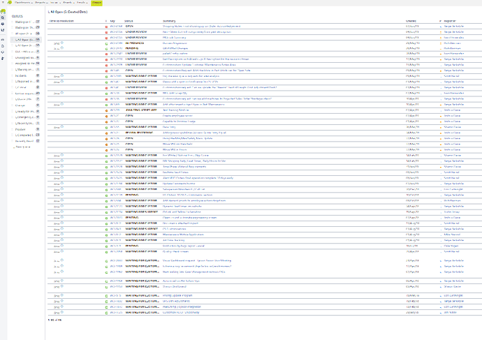

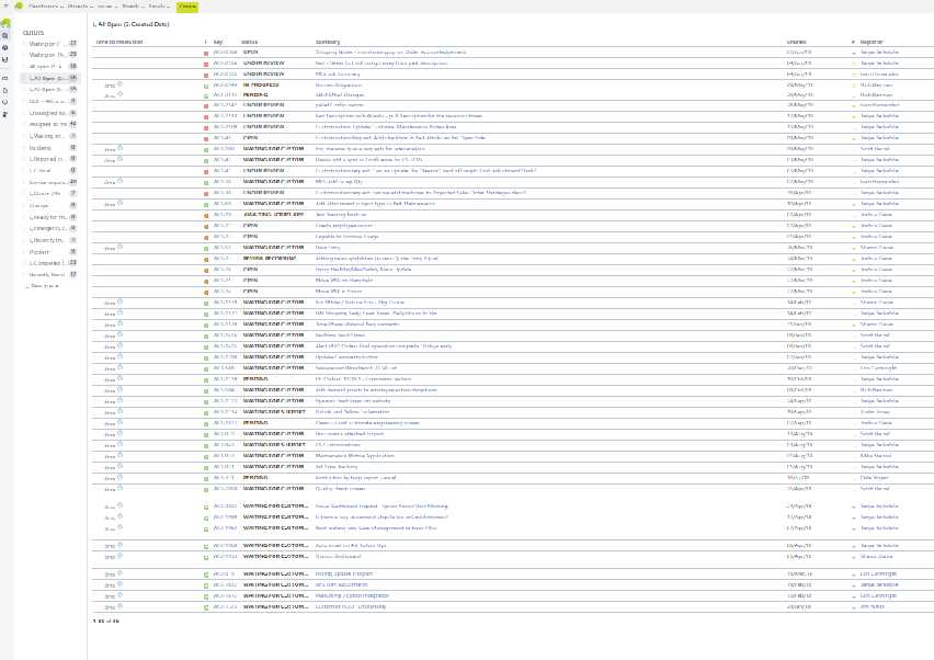

Tim’s example would literally be the difference between 15 minutes and 4-5 hours (including damage control). By the time you do process discovery(vs a quick band-aid), add the UD fields and regen (maybe regen again becuase the first time decided it didn’t want to work), document the fields for CAB, fight with the two customizations because #anchors, deploy the customizations to production, listen to everyone bitch because their personalizations broke, train them on what they need to maintain that they will never remember (which is fine because it may never be used again) you will have blown 20x the time that could have been spent streamlining a production process.
My work queue P1. Every minute counts and if it’s a minor NVA rule i’m not going to give it the time of day over PI/CI.
