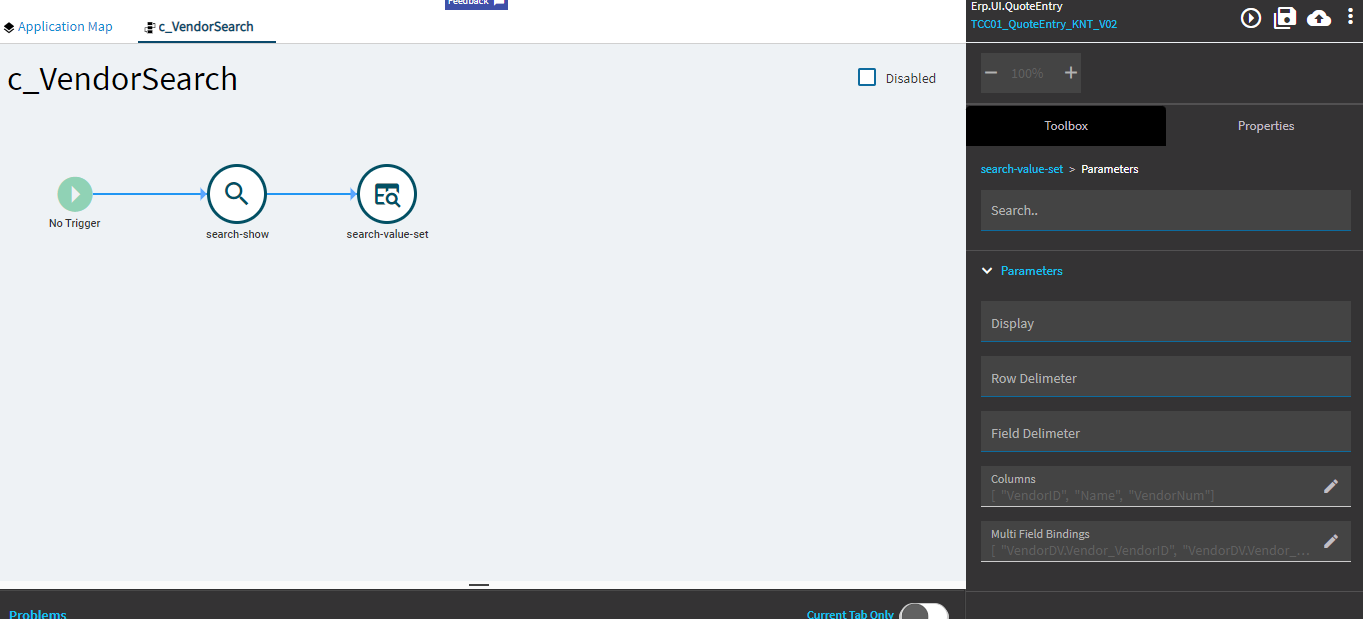

I have a custom search event setup to return the VendorID, Name, and VendorNum. This mostly works, however if I hit cancel after searching “Search-Value-Set” is returning the blank data from the search results.
Is there to only run Search-Value-Set if the OK is selected in the search window? I messed with a condition statement for awhile, but couldn’t find a valid expression using actionResult or searchResult as the dataview name.

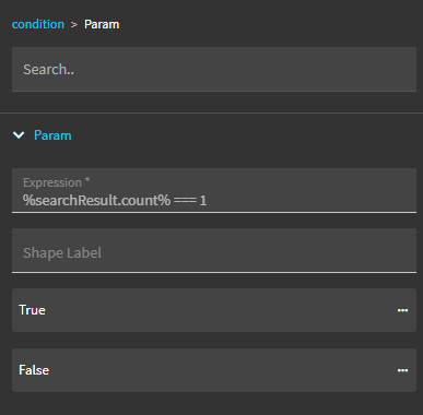

Looking at an out-of-the-box search event, they have a condition after the search-show:
%searchResult.count% === 1
That was it! Thanks @jwphillips
