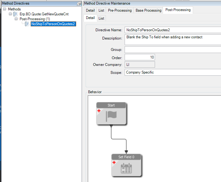

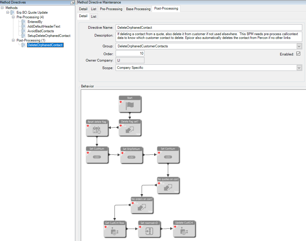

  1. With a BPM, blank the ShipTo field on new Quote Contact. May not be for everyone.

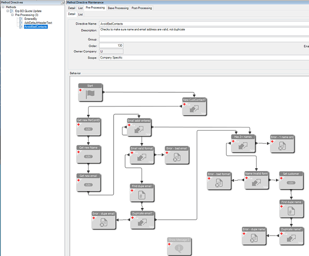

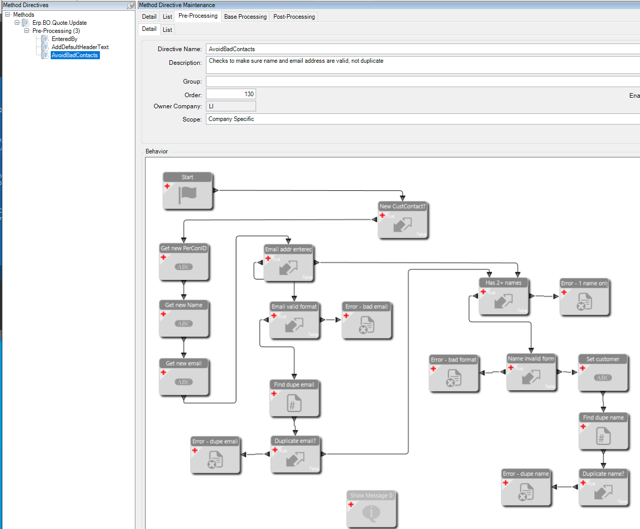

  2. Added BPM that checks for duplicate emails, duplicate names, and name formatting issues.

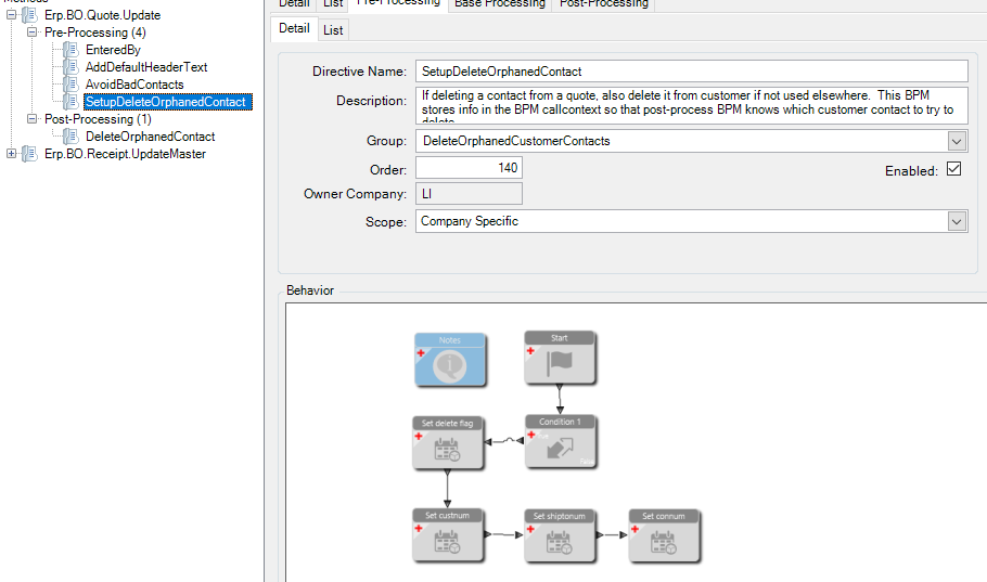

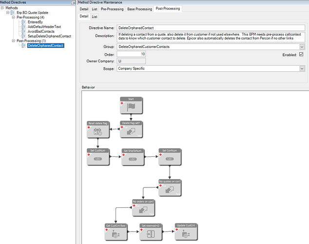

  3. Added BPM to delete contacts from CustCnt and PerCon tables, when deleted from a quote (if the contact is not on any other quotes or orders). Attached as this should be built-in functionality IMO.
    DeleteOrphanedCustomerContact.bpm (93.1 KB)

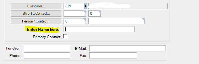

  5. Customized Quote Entry Contacts page a little bit
  6. Sent out an email telling everyone how they can now edit contacts, and how the Partial Match dialog works. In our installation/version, on Quote Entry, OK uses an existing contact, Cancel creates a new contact…
