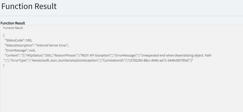

However I tried testing it again and I get this function result in the tester:
what is the proper format to send a UD14 tableset with your function tester? I am trying this right now:

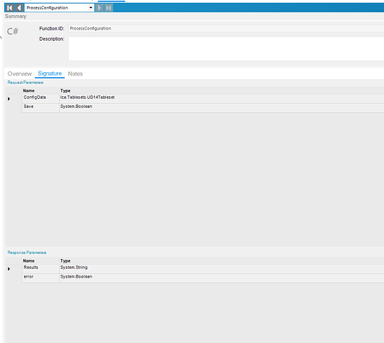

Got it go into /api/help and see what OData expects it to look like. Paste that in here screen shot or something. I’ve never tried a tableset but I suspect it wants it named
"ConfigData": {Table set here}

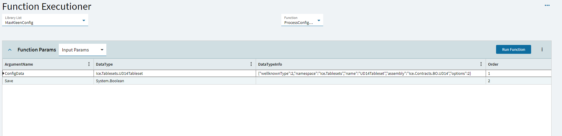

Yeah it looks like it wants some sort of “special” string format but I can’t figure out what that is. It only “asks” for a “String” parameter. UBER Gross
I got my format by making a function that returned a UD14 table set, I figured that would give me the right format..
Yes but it looks like its expecting a little something different. Still poking on my end.
Here you go @Evan_Purdy updated the library. Problem was it was treating the Tablesets as Strings
