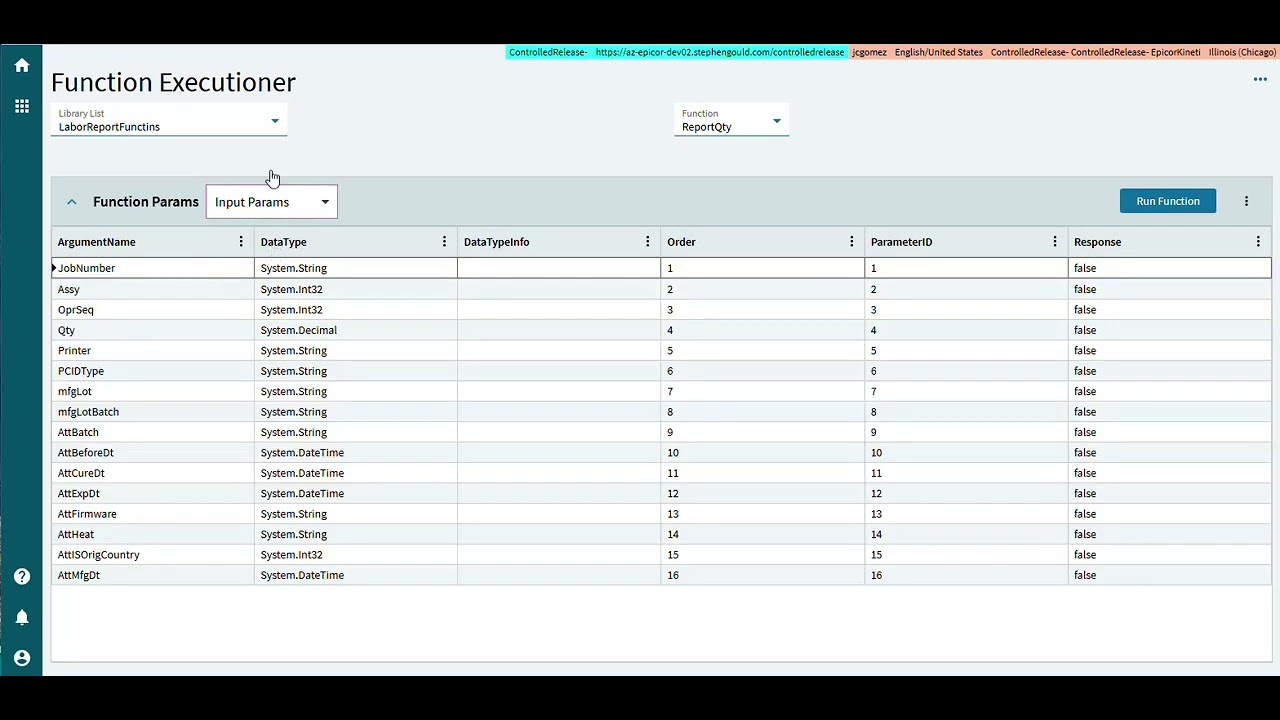

So, for my first real Kinetic project, I decided to truly test my patience (and my will to live) by building a Dynamic Function Tester UX in App Studio.
And thus was born:
:drum: THE FUNCTION EXECUTIONER :axe:
(No, the name has nothing to do with the existential crises triggered by the tooling and my urge / desire to get a bit stabby…erm I mean cough…. Nothing at all. :neutral_face::zipper_mouth_face:)
After much weeping, gnashing of teeth, and gentle screaming into the void, I’m proud to say it works! And dare I say… works just as well as the Classic version we wrote a while back. Sure, I had to bend a few rules, maybe summon a few demons… but I made it through.
Kinetic and I aren’t friends yet. But we’re at least nodding acquaintances.
It should be able to run any function in your system (published or not) and it will generate a Parameter Entry Form via a Dynamic Panel regardless of the Parameter Types.

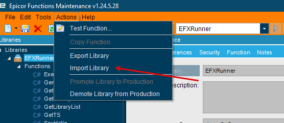

  2. 5.1. Download this updated version of the EFX Library with tableset support
    EFXRunner.efxb (15.8 KB)
    5.2. Install it by importing the EFX in Function Maintenance
    5.3 Select the file, pick upgrade and hit ok

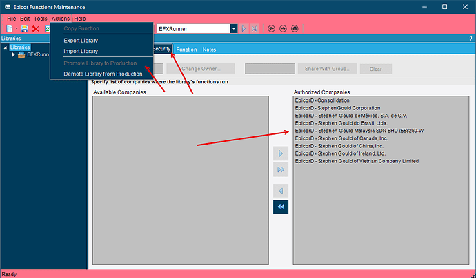

  3. Go to the Function Maintenance Screen and make sure that your Company(ies) have access to the function and that it is promoted.
  4. Refresh the Entire Page / Reload the App to Load new Menu

Make sure that you give your Company Acccess to the Functions (after import) and that you promote it
(App and Layer)

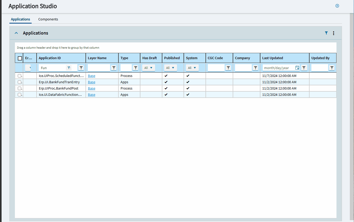

The App is Called: Ice.UIDbd.FunctionTester (This was named before App Studio took all my will to live away)
FunctionExecutionerAppAndLayers.zip (6.4 KB) >= 2024.1
