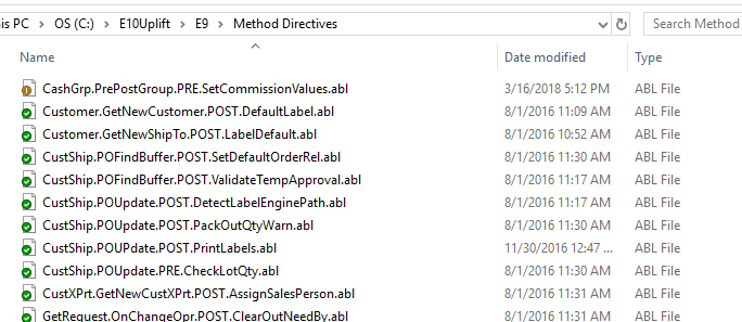

I like to keep a local Uplift folder with everything extracted. E9 and E10 then I can always use it for reference and use WinMerge to compare.
2018-11-07_0737
2018-11-07_0735
