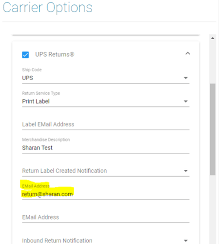

“UPS Returns” was created in ERP in Ship Code Maintenance.
The carrier is selected here as well but it has to be created in ERP in Carrier Maintenance.
Then you use “UPS Returns” (in my example. It can be whatever you want to name it) as the “Ship Code Key” when you set up a new Ship Code.
