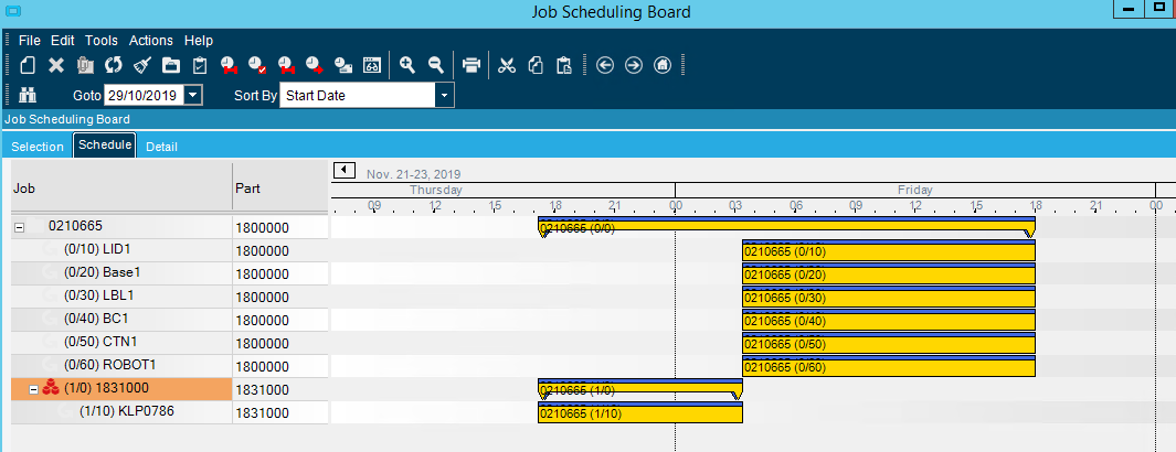

We have a final assembled product that has a part created by a sub assembly in the MOM. There needs to be a lag from when the Sub Assy Job starts to when the 1st op in the main assy job starts (its actually a cooling period as the component in ASM 1 is injection molded). For efficiency reasons we don’t want to wait until the sub assy job has finished, we only want an “X” hour time difference between ASM1 OP 010 starting and the ASM 0 Op 010 starting. We know this can be done with ops in the same assy but can it be done from a sub assy to the main one.
The current job is scheduled as below, note that ASM 1 is finished before ASM 0b OP 010 is schedule to start
What we want would be similar to below, where ASM 0 Op 010 starts after delayed offset from ASM1

Our issue is that we can’t see how pull Op 010 of ASM 0 to start before the end of op 010 of ASM 1.
If we have 15 hours of molding and 20 hours of assembly, we dont want Epicor to be planning the start of the next job 35 hours after the start of this one( as per 1st image), we should have the molding start then 3 hours later start the assembly with an elapsed time of 23 hours (as per second image).

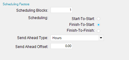

Have you tried send ahead offset?
Hi Chris
We’ve tried this and it only seems to work (and we’ve been told this by our local Epicor Consultants) for Operations within the same assembly, not between Sub Assemblies. Do you know if this should/does work across assemblies and any other tricks that make the magic happen?

Hi Zack, Thanks for the suggestion.
We’re not trying to push ASM 0 Op 10 out, we want to run it earlier.
At the moment (see 1st Image) if ASM 1 Op 10 “0210655 (1/10)” is planned to run for approx 10 hours. Then ASM 01 op 10 “0210655 (0/10)” starts and runs for approx 15 hours, this gives an elapsed time of 25 hours and means the next job would be planned to start at 18:00 on Friday.
What we want to happen is that “X” hours into “0210655 (1/10)” (as per 2nd image this is 5 hours) the 1st components of “0210655 (1/10)” will be cool enough to use so we want to start “0210655 (0/10)” at this point. This would give us an elapsed job time of 20 hours resulting in the next job planned start at 13:00.
If this was op 10 and op 20 in the same assembly we would be able to use Send ahead as per @cbradford suggestion, but its the Sub Assembly barrier that seems to cause the headache
