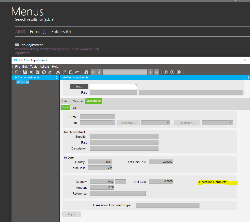

just noticed your post, you can complete these subcon operations manually using the Job Cost Adjustment Entry screen, but if you need to do that automatically, then you need to create a BPM to be triggered when receiving these sub./con operations and satisfying whatever logic you need (i.e. you need to cater for many sceneries here e.g. when receiving a partial qty, then what do you want your BPM to do ?), then calling the end activity / completing operation BO method.

i do not understand what you mean mate, there is no issue in the subcon operations, it is dispatched then received, if you receiving the full quantity then Epicor will close it automatically, if not Epicor will not close it until you clarify the remaining qty and do this manually, i.e. NCR/DMR/Scrap or return to subcon and receive it as is, if you are not using quality module, then you can create a BPM to call this BO closing method and apply it at receiving SubCon.

yes, the best thing is to create the scenario in Test or Pilot to clarify the problem, if i convert my reply in example
  1. 10 parts SubCon dispatched, then 10 Received Ok, Epicor will close this SubCon operation in the relevant Job BOO
  2. 10 parts SubCon dispatched, then 8 Received, Epicor will not close the operation, now you can use Job Cost Adjustment Screen to close the operation with this short, or create a BPM to do this on receiving, however in this case your Job WIP quantity will be always less than required quantity so if this is ok with you then go a head.
  3. 10 parts SubCon dispatched, then 8 Received, and 2 sent to the Quality Area NCR/DMR, now Epicor will not close the operation and you will not be able to close the job when finished until you clarify these quantities
