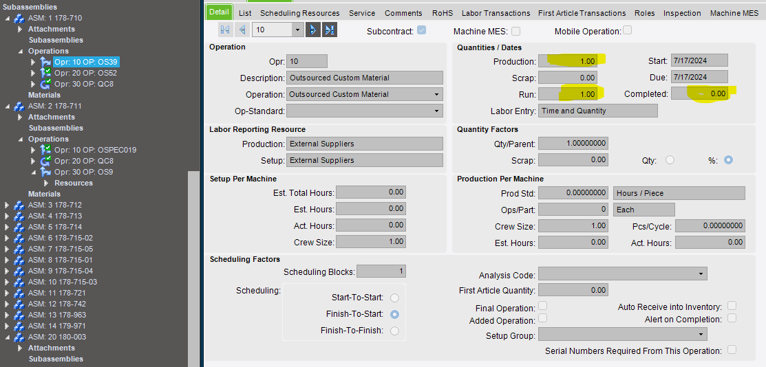

We have completed subcontract operations not getting marked complete sometimes.
We’re receiving the full qty, but the qty isn’t always showing up on the job for some reason… not consistent, as sometimes they do get the qty right and show as complete.

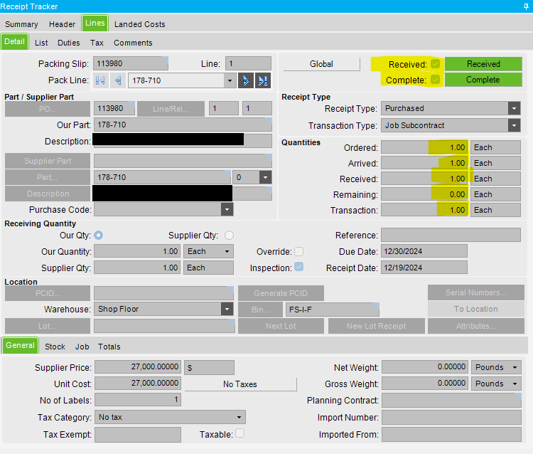

Based on your receipt snip, the parts should have gone into inspection. Was the inspection process completed?
Oh great eye! Thanks for the lead. Got 10,000 steps in chasing that down…
Turns out that is the 2% problem, as we don’t use the inspection function. And I’m still stumped…

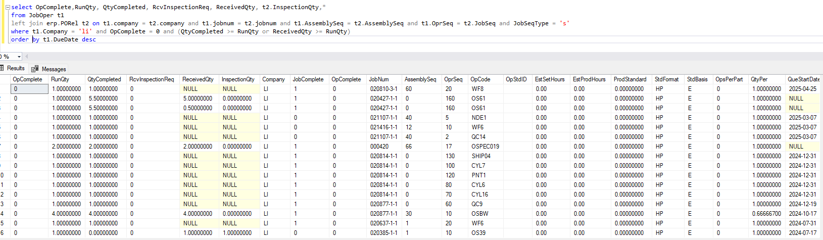

  • But I’m seeing 211 operations, with completed qty or received qty greater than run qty, that are still shown as incomplete (OpComplete = 0).
Any other ideas on what else I could look into…?

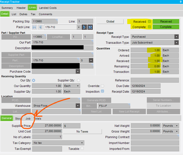

So, if you look at the RECEIPT for one of the remaining trouble operations… may be under the job tab. There should be a checkbox labeled “Issued Complete”. Is that checked?

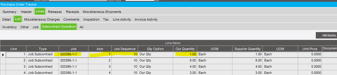

Created a job w/ a subcontract op.
Created a PO for that op.

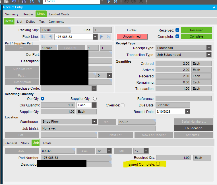

BUT, then I noticed that “Issued Complete” checkbox was checked by default (and should if the quantities match up). BUT I then unchecked that checkbox and now the operation on my job no longer shows as complete.
Can you verify that? Sorry, I’m looking at Kinetic screens and not Classic, but I would assume it would be in here:
Well I’ll be damned, that looks to be the culprit. Now I need to figure out why that is happening. Thanks so much!!

Most of the completed but Not-Issued-Complete operations are from having 2 different receipt entries for the same release. Thanks to @dcamlin for pointing us to KB0137803. I’m going to add a fix for this with a BPM, to mark it Issued Complete if the full received quantity meets or exceeds the job demand.
A few of the other instances look to come from the job operation quantity/parent being later lowered to match the received qty. There are posts here suggesting to add an IssuedComplete / OpCompete checkbox to the screen customization, but I don’t really like that. And a BPM doesn’t seem right either. Maybe a note to tell them to fix the reciept to be IssuedComplete if they have to do this again.
There are some where RcvDtl.IssuedComplete shows as 0 in the database, but when viewing in receipt tracker, IssuedComplete it is Checked! So maybe it is checking vs the job… though on the job there are some of these that show OpComplete = true and others show it False… baffling.
And then there are others that are both 0 in database and unchecked in Receipt Tracker, where I can’t tell why IssuedComplete wasn’t checked… with that, we’ve got every possible permutation of how it could be screwed up.
