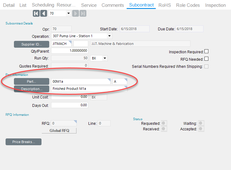

Already follow the user guide for subcontract setup, but never get the expected result. The result always the part that you can receive is the part that you sent.
Anybody can help me how to setup based on the requirement, or how to do it in Epicor?
By default that would be the part you ship. The supplier part number could be used to help with clarify things with your supplier, the sub-contract shipment packing slip could also be updated. In subcontract shipment entry the job number is needed not the part.

you need two part numbers…
W1 = RodWire - it can either be a MAKE or a BUY product… you need to acquire this into stock before you can make the other part.
W2 = Wire - it has a BOM and a BOO.
W2’s BOM contains some W1 to make the W2.
W2’s BOO has at least one operation. that operation is a subcontract type operation that sends the material W1 to the supplier to provide the service which turns it into a W2.
So… assuming you have a requirement for some W2, you would “sell” W2. MRP would run and create a job for W2, which would create a demand for W1. The system would tell you to make or buy W1 and put it into stock. Release the W2 job, Then issue W1 to the W2 job. the W2 job would also create a sub-contractor PO for the sub-contract work. once you Then ship it on a sub-contract shipment to the supplier/PO referenced. when you receive the SubContract PO, you complete the operation as well. then Receive the W2 job to stock.
