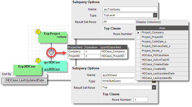

I’m hoping someone can straighten me out on what seems to be a very simple subquery that doesn’t seem to be returning records in the manner I expect. I think I’m just having a bit of a brain-hiccup on setting up the BAQ properly to obtain the expected results.
Basically, I’m using the [Erp.Project] table linked to the [Erp.HDCase] table (which is set up as a subquery) in order to return the most recent case record associated with each individual project record. The [Erp.HDCase] subquery is sorted by [Erp.HDCase.LastUpdatedDate] and is selected as a “Top 1” query. The strategy here, as previously mentioned, is to grab only the most recent case record from that table.
Here is a general depiction of the BAQ configuration:
So, what’s the problem?
Well - I return all of the field values from the [Erp.Project] table with no issues, since that is part of the the “top level” query. However, I receive absolutely NO values from the [Erp.HDCase] table - UNLESS - I have ALL values entered from the group of fields I am requesting to be returned from that table. If I create a new case record with only a few of the fields filled in, the query never picks up that new case record. It seems that ALL of the values for the case record need to be filled in.
It’s fairly obvious that I’m stumbling on something pretty basic. Do you guys notice anything glaring that I’m missing either in the BAQ set-up, or in my expectations on the returned values?

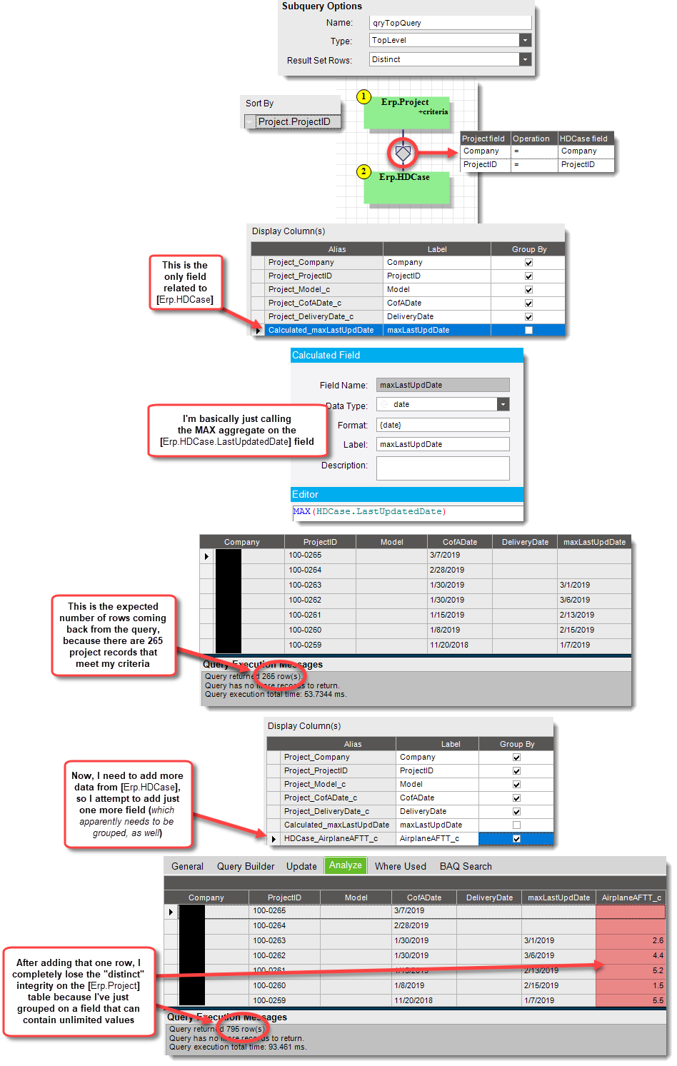

After tinkering a bit on this, it seems I don’t quite understand subqueries as well as I originally thought (or, at least it appears to work differently in the BAQ Designer than it would in SQL).
So, I start with the [Erp.Project] table and set it to return distinct records with a specific date criteria. I then pull in the [Erp.HDCase] table and link it by [Company] and [ProjectID]. I create a calculated field to set up the MAX() aggregate on the [Erp.HDCase.LastUpdatedDate] field. That calculated field is now part of the query and seems to play nicely.
As soon as I pull in another field from [Erp.HDCase], the query requires that field to be part of the GROUP BY statement – and that’s when I lose integrity on the [Erp.Project] table… because I can’t really group on a field that can have unlimited values in it, as those values now become distinct GROUP BY data points.
Here a depiction:
I might be overthinking things a bit, perhaps.

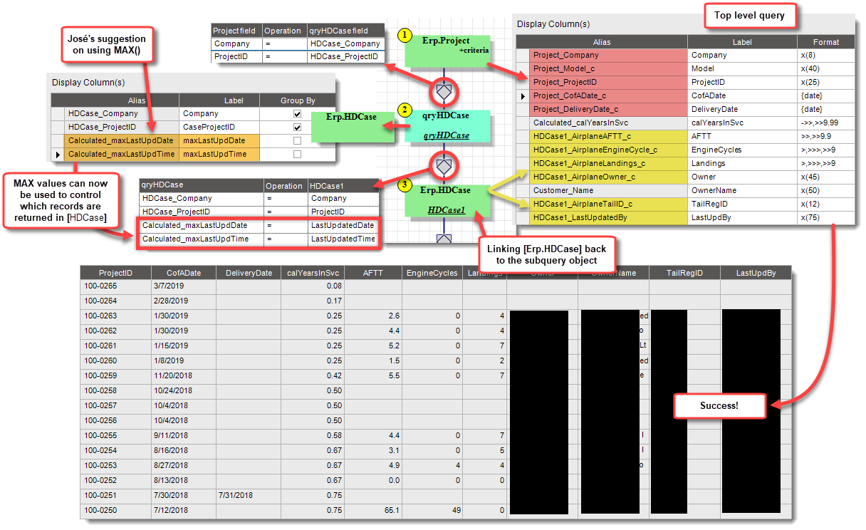

Before you do that… I’ve made some headway and I’d like to post what I have (by tomorrow morning) so that you can evaluate. I’ve basically used pointers literally from you, @Chris_Conn and @josecgomez throughout the thread.
I’d like to try and explain it from my perspective and maybe y’all can tell me if I’m off/on track. More to follow after I put everything together.
@Banderson - as I understand it, the subquery is essentially an embedded query that resides within a larger, base query and it is typically used to further modify the returned data derived from the base query (best I can describe in a nutshell - but I’m sure there’s a more potent definition out there).
What was tripping me up, mostly, was I had assumed that the additional fields I might want to have returned from the subquery should be defined in the “subquery object”. Why? Because that’s where I’m pulling in the [Erp.HDCase] table – directly to the “subquery object” (it’s all graphical in the BAQ Designer, so that’s why I’m referring to it as an “object”). However, that subquery object is nothing more than a limiter that further modifies what I need to have returned from the [Erp.HDCase] table (which is why @Banderson and @Chris_Conn had suggested to link the [Erp.HDCase] table back to the subquery) . I’m sure y’all might be able to explain this a bit better than what I’ve described here.
I used @josecgomez’s suggestion to employ the MAX() aggregate, as you’ll see shortly, but it took me a bit of time to realize that what makes that work is creating it within the subquery and then linking that over to the same field (non-calculated version, of course) in the [Erp.HDCase] table. So, I’m telling [Erp.HDCase] that I need it to show relative rows equal to the MAX last updated date. And you’re correct - I had no need to set the “DISTINCT” limiter on this at all.
Here’s the depiction:
End result is that it’s giving me precisely what I expect (and need).
I’m obviously going to require a bit more practice putting subqueries together in the BAQ Designer before I fully understand it 100%, but each of you provided me with a nice foundation to work from. Much appreciation to you guys.
