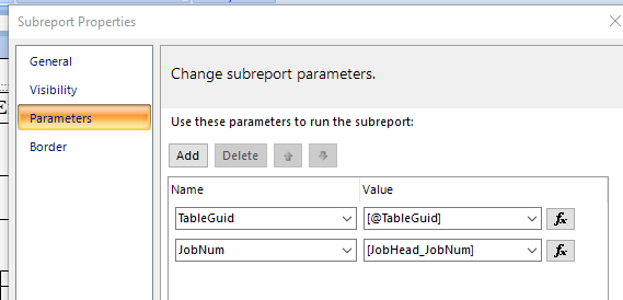

If you want to use the same dataset as your main report, you just have to pass that @TableGUID parameter from the main. Then your query will know where to look (if you didn’t mess with it too much from the Main-> Sub anyway)
Do I have to add a parameter in at the BAQ level, or can I just do it in the report builder?
Just the report builder. If you go to your subreport properties you will add it there.
image (Job number is an extra for my report)
And those parameters must match the ones in your subreport:
