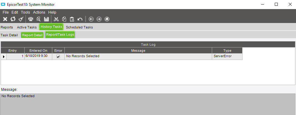

Can you post the error message again? From the system monitor?
There is no error showing for the subreport for the AR Invoice. Only place it is showing is in the Report Server Log.
