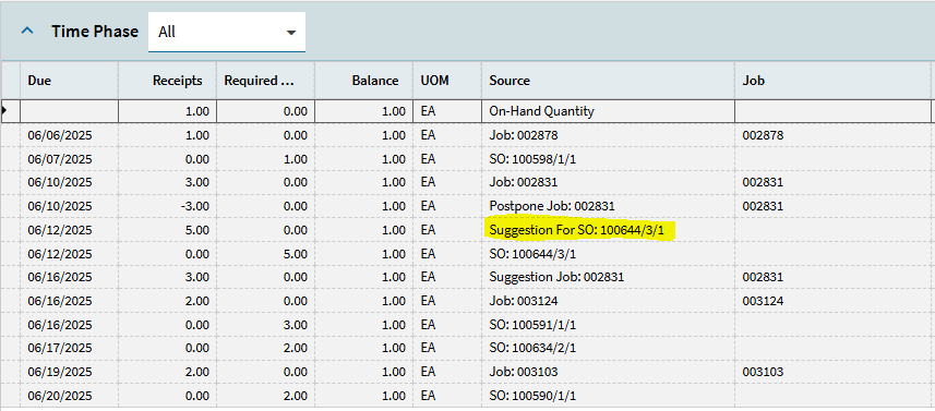

On the parts that did not create jobs and I did nothing with, there is this in Time Phase.
Where do you see … Suggestions for SO ( yes that is the sales Order that didn’t create jobs) .

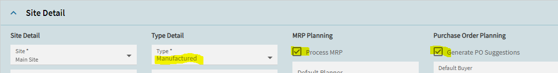

Here is something odd… Mfg Part with Generate PO Suggestions…
That’s normal. If you ever have subcontract operations, you’ll need that on.

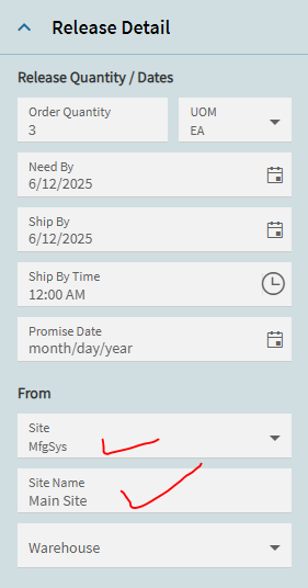

As @Banderson said, check that the Release is set for the correct Site.
Only 1 site
To clarify, Multi Company. Each company has 1 site
Not that this holds any bearing… but why does your balance never change in your Time Phase image?
Part is Make Direct, Never hits Inventory. Transaction is Mfg to Customer when it ships
