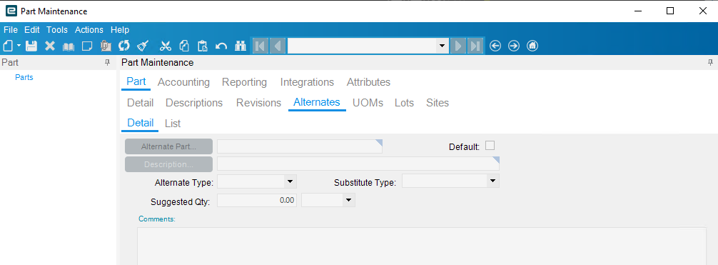

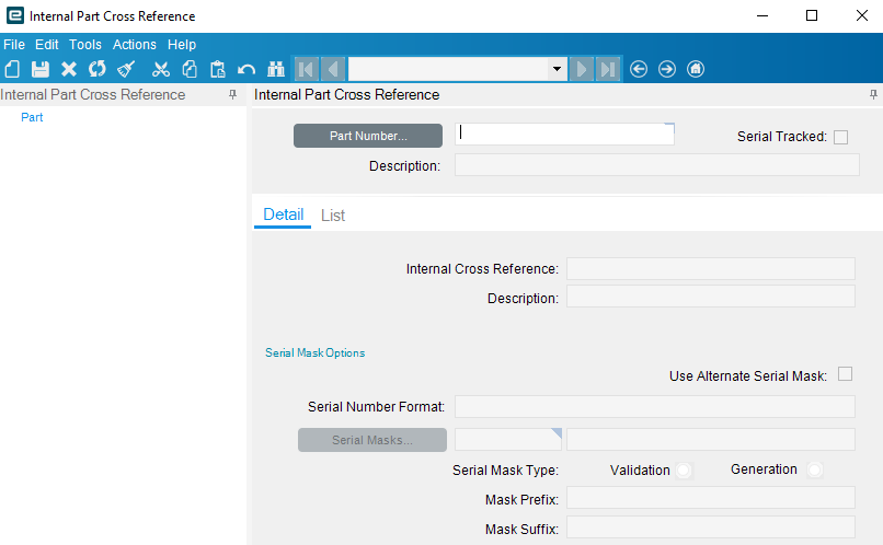

I don’t think there’s a CAGE Code field anywhere but you can try a couple of things:
Create an Internal Cross Reference
Add CAGE Codes as parts and use Part Alternates
@laura.roppelt We added them as UDs
I like the idea of using the Alternate part number. One alternate can point to many different parts if you like. I have had customers in the past use the Alternate PN for grouping parts… for example, they created an Alt PN for “Bolt” and assigned it to all their bolts. Then in sales, you could type in BOLD in the part number, and Epicor will show all the parts that are bolts.
But the idea of using a UD FIeld on the Part table also works. or a UD Table that links the Part/Customer/Cagecode and Part/Vendor/Cagecode would be more robust.
