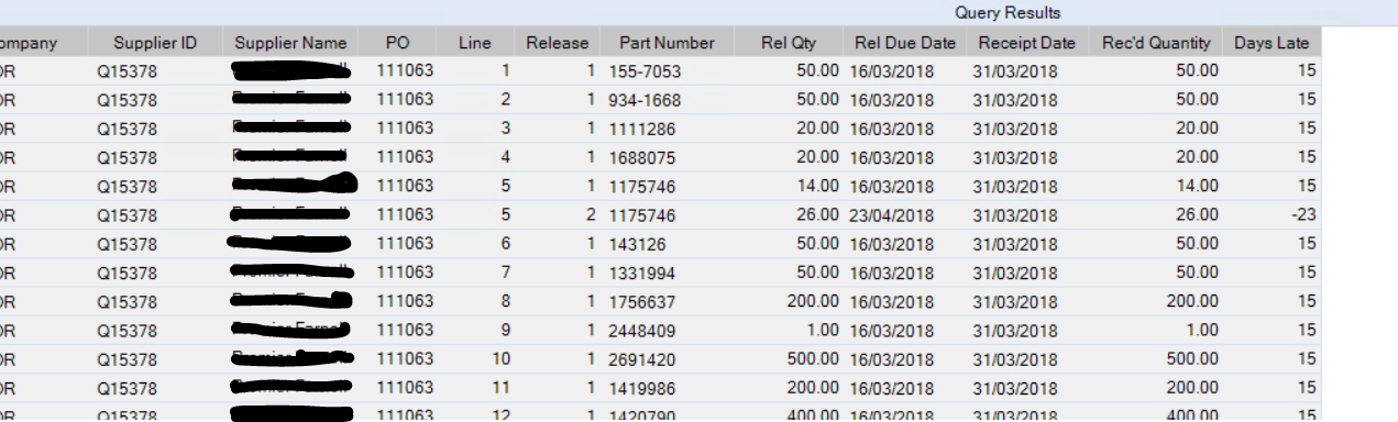

What I did was create a BAQ against the PO Receipt lines. A column was to calculate the due date vs the receipt date and then a on-time logical column based on standard criteria.
As an example if the company standard is within 0 days early and 2 days late the like was set to ‘O’ else if Early then ‘E’ and if Late then L.
Then using the BAQ created a dashboard with a supplier filter and receipt date cutoff.

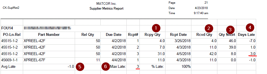

Three panels on the dashboard (on-time receipts, Early receipts and Late receipts).
Average late (average of days late. Might need work as you may want to have “early” receipts count as 0 days late, or weight it based on qty. Right now, getting 1 pc 10 days early, and 49 pcs’ 10 days late, averages to 0 days late).
Max days late

The data is starting to come together, just having a few problems with the running totals for:
“Received Qty Running Total” and the “Quantity short” calculation…

It should be fairly simple though. POReceiptDetail to PORelease to PODetail to POHeader to Vendor
Create a calculated field calculating the number of days between the PO due date on the PO release and the PO Reecipt.
Create a calculated field if the number of days creates an “E,L or O” field depending on your on-time standards such as:
IF NumofDays <=0 then (Early Standard) Then “E”
ELSE IF Num of Days >= (Late Standard) Then “L”
ELSE “O”
From there you can build the dashboard panels filtering on the calculated field you created for the code. Or just have one on-time panel color coded based on the field code.
