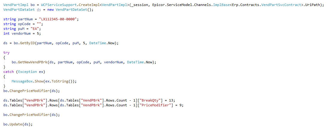

I am trying to add price break rows using code, it runs and there is no error, but when I open Supplier Price List, I don’t see the rows there! Am I doing anything wrong in my code?
VendPartImpl bo = WCFServiceSupport.CreateImpl(_session, Epicor.ServiceModel.Channels.ImplBase<Erp.Contracts.VendPartSvcContract>.UriPath);
VendPartDataSet ds = new VendPartDataSet();
        string partNum = "LX112345-00-0000";
        string opCode = "";
        string puM = "EA";
        int vendorNum = 5;
        ds = bo.GetByID(partNum, opCode, puM, 5, DateTime.Now);
        try
            bo.GetNewVendPBrk(ds, partNum, opCode, puM, vendorNum, DateTime.Now);
        catch (Exception ex)
            MessageBox.Show(ex.ToString());
        bo.ChangePriceModifier(ds);
        ds.Tables["VendPBrk"].Rows[ds.Tables["VendPBrk"].Rows.Count - 1]["BreakQty"] = 13;
        ds.Tables["VendPBrk"].Rows[ds.Tables["VendPBrk"].Rows.Count - 1]["PriceModifier"] = 9;
        bo.Update(ds);

If you try and comment out the second (or the first) ChangePriceModifier, does it work ? Also, if you try it with a part that does not have records in VendPBrk, does it work the first time ?

I actually had to add that line twice based on Epicor logs. Removing it, doesn’t work no. I have tried.

Can you move everything into your Try block? (bo.ChangePriceIdentifier through bo.update()). While you’re not currently throwing an error, if you do, you’ll be able to get some reason. Whenever I’m doing array access, I find it’s possible to be out of range for example. If there is an existing record, you would want to check that as well. Might shed some light on what is happening.
Take a look at the event logs on the app server (that’s the windows event logs, not the server.txt). I have seen instances where no run-time errors are thrown to the UI but errors exist in the event logs.
The thing is it saves everything and when I load the vendor ID, in the code I can see all data is saved in the table in dataset, but when I run Epicor and open the same Vendor ID, the list is not there!! And I am opening the correct Vendor, I have checked it many times.
What happens when you run the exact same methods in the exact same order in the BLTester?
Good suggestion! Haven’t tried that yet. Will give update.
