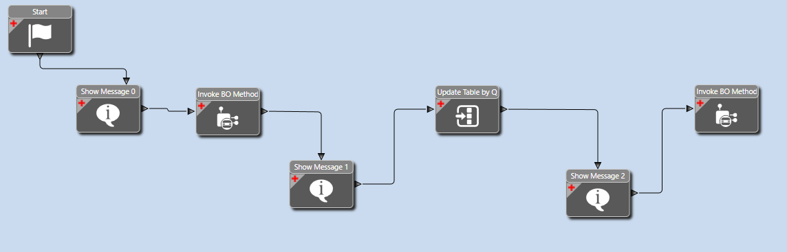

I am try to write a post processing BPM on the update method of PO. I fallowed and example that I found and can’t get it to work. Can someone lend some help please. I have not dome many BPMs before.
Here is a screenshot of what my BPM look like:
The message show what I am expecting them to but updating vendPart is not working.

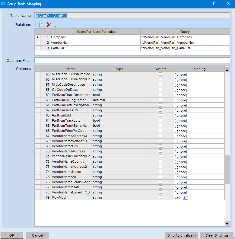

Are you setting the rowmod field to “U”?
I am not. should I?
I did this in the update table by query node but still not working
I take tat back, it looks like it did work but the supplier price list screan didn’t refresh right away.
Thank you for pointing that out.
How would I add a record? Set the row mod to “A”?
I tried that and it worked. I answered my own question.

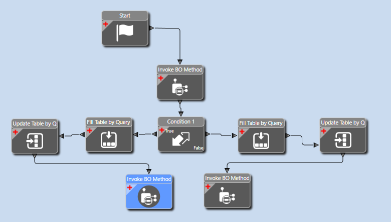

I need some help. I cant figure out my update is not working. My add works ok. here is wat my bpm look like:
I goal is to do the update when the result of the condition is true. I am adding a record when it evaluates to false.
I got it to work. Thank you four your help.
