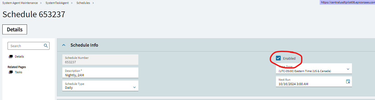

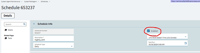

I would make the support team aware. We do not see that behavior on our refreshes because they disable the schedules. I believe that is supposed to be part of their refresh process.
I just had ours refreshed last week and the schedules were still enabled. Can’t say I’ve paid too much attention in the past as we didn’t have reports scheduled until recently. Just scheduled tasks like generating suggestions, etc.
That being said… the Schedules are still enabled… but I don’t see any “scheduled tasks” in the System Monitor. So, they must be disabling those via a different path??
