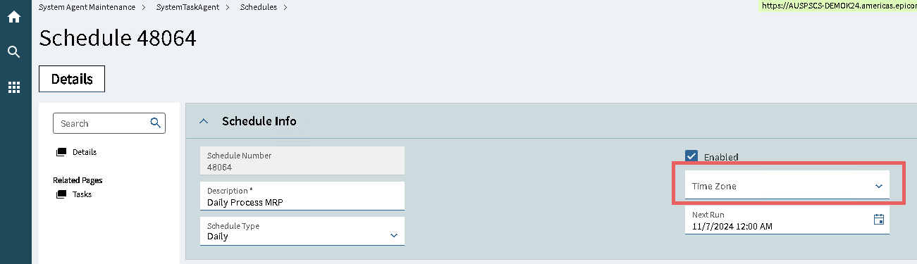

Has anyone noticed issues with jobs scheduled via the system agent failing or crashing this week? I have MRP scheduled to run at 11PM EST nightly and it’s crashed each night since Sunday’s time change. I’ve seen other threads about an update, but since we’re on cloud I don’t control that.

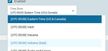

Do your schedules have the Time Zone set within System Agent Maintenance? As of Kinetic 2024.1 (for Kinetic Cloud customers–do not recall the specific 2023.2 point update where this was addressed for on-prem customers), any schedules with a time zone explicitly set within System Agent Maintenance will continue to execute at the same local time set on the schedule when DST changes.
Yes I had it set to Eastern Time. However while looking at the list I see there is and Indiana East, which I’m in. Perhaps it should be set to that one? Scheduled start time is 11PM.
