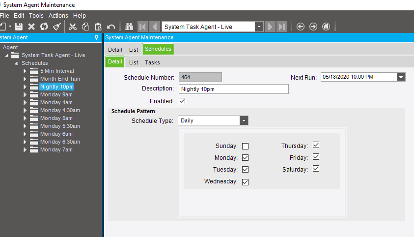

We have the following schedule in our System Agent
So we want this to run EVERY Night at 10 PM (EST) (Except Sundays)
However it did not run last Saturday (and checking back it has never ran on ANY Saturday, instead it is actually running on Sunday) :zipper_mouth_face:
After much Investigating we found the following.
10PM EST is stored in the Ice.SysAgentSched table as 2AM (GMT) the next day
So Saturday 10PM is stored as Sunday @ 2AM
While looking at the run History for the process we see that it dutifully runs at 2AM (GMT) as expected on Saturday (which is the Friday 10PM (EST) Run)
However then it Skips the 2AM on 5/17 (Sunday) which would be a Saturday 10 PM (EST) Run My guess is because we told it not to run on Sunday
It appears that it is doing the Day of the Week check on GMT time, while running the schedule instead of converting it to EST before checking which causes it to run on the wrong day of the week

The good news is that you can adjust your time so that it will be 10PM. This sucks, but should work fine. Maybe submit a bug to Epicor? You’ve already documented the issue beautifully.
I don’t think the issue is that it’s not running at the time the UI says. But rather the Day of the week is off, when the time displayed on the UI is before midnight, and it’s UTC equivalent is after.
YUP you hit it on the head.
