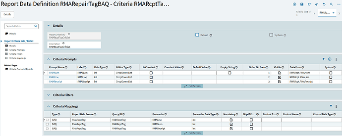

- Created the BAQ, which returns the record data to print, with Parameters for the Keys that identify the record uniquely, in this case, RMARcpt.RMANum, RMARcpt.RMALine, and RMARcpt.RMAReceipt. It does facilitate prompts to run the BAQ Designer when you first test it. I thought âAwesomeââŚsaved.

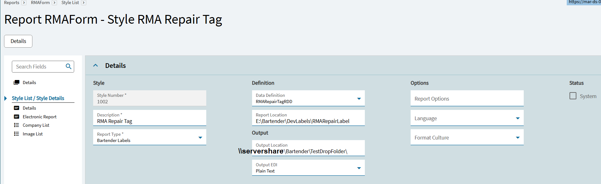

- Launched the RDD form, Created a new RDD from scratch, with Report Type = Bartender Labels, saved.
- Added the BAQ in Step 1 as the data source, (No relationships needed), saved.
- Within this RDD, next defined new Report Criteria ID, saved, saw that it now appears as a link, drilled into it. This step surprised me a little. It gleans, the parameters from the BAQ as source mappings. âCoolâ. After a bit of poking around and a couple of mistakes, I found in its elipsis (snowman), the command âCreate Report Criteria Prompts from Selectedâ, and backed up.
- Selected the three gleaned Criteria Mappings check boxes. Saved.
- Now used that âCreate Report Criteria PromptsâŚâ command. It creates the basic Prompts in the panel layer above called Criteria Prompts.They are links so drilled in.
- Double checked each of the data types, sequence etc, saved, Up and into next one, repeat. Saving each time.

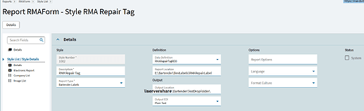

- Launched Report Styles and created a New Report ID, (not a style on an existing Report). Save. Created its report Style. Report Type = Bartender Labels. Ref the RDD in the Data Definition dropdown. Ref Report Location on Bartender server. Ref output location on BT server.Save. Form changes a bit and Report Criteria appears. Select the Report Criteria defined in step 4. Go to "Generate Form and get my prompts, fill them in and finally get a well formed BT file in the output folder. âWow! Iâm thinking those BAQ prompts are going to flow all the way to this Report style and âautomagicallyâ present at print time⌠super cool.â
- Go to RMA Receipt line I have been using and print, selecting the Report Style in step 8, with great confidence that the missing parameter key issue has been resolved. No prompts presented. Hmm? Same error as all the other times. Grrr!
Silly Me! My naive assumption was that the BAQ parameters/prompts have carried through to this end and that the standard Print mechanism would prompt and print. But as it turns out, the standard print mechanism has no idea whatsoever that there are parameters now containing keys or what to do with them anyway. It has no sight into those or the dataset in general as evidenced from other print attempts using an modified RMAForm, I tried to leverage that but found no way to add the necessary tables and provide the specific record keys. I presumed too much. Honestly, if there was just a little more awareness in the printing mechanism working with the Report Style chosen, to also do some criteria gleaning from the report style, it would be a decent adhoc label creation work flow.
