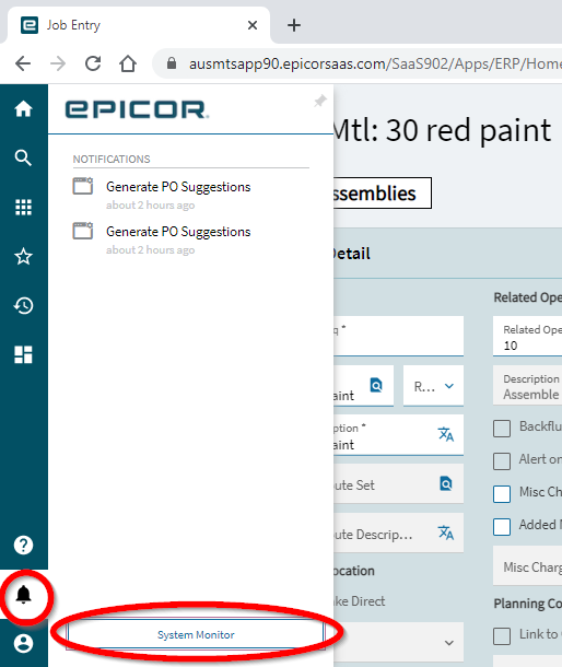

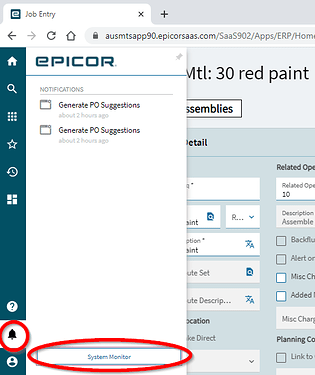

Hey… while on the subject of System Monitor… In Kinetic, the access to the system monitor is no longer hidden down in the menu bar. It is now directly in the application. Below is where you can find it… first screen shows the option in the Notification window:

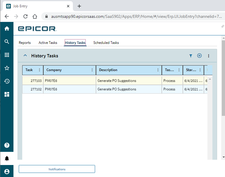

If you press the System Monitor button, you will see a screen similar to what you always saw before:
Another piece of good news: The System Monitor seems to auto refresh, so if you are waiting for a task to finish, and you are one who likes to “Watch the water boil”, this feature is for you.
