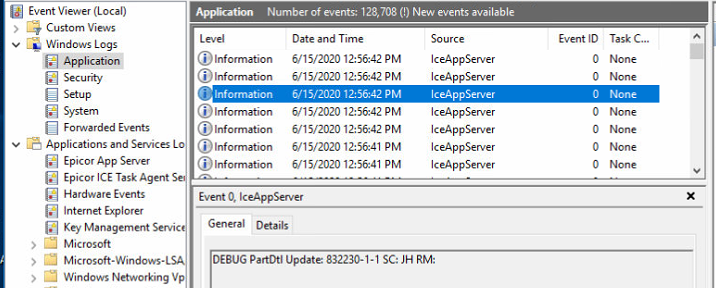

System running slow. App Server log jumped to the Windows application log
What determines where the event viewer logs go to? Starting last night the App Server logs are going into the regular windows application log. A open with time phase that should take 10 seconds is currently at 45 minutes and still has not finished. I have an open ticket with Epicor and am waiting to get a call back.
I have bounced the box twice and no change. The event log process is using 8% of the cpu.

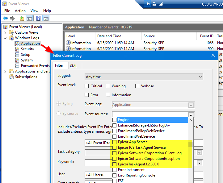

Here’s a screenshot of Event Viewer on our App server. Note the number of entries with “Epicor” in the name of the Event Source:
edit

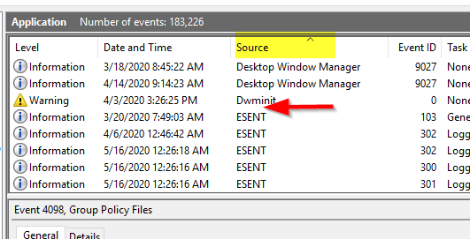

Hmmm … but when I Sort by Source, there arent’ any entries for those Epicor Events.
I wonder if there events of those source in the past - which have since been deleted - and that’s why they appear as enteries in the filter’s dropdown list.

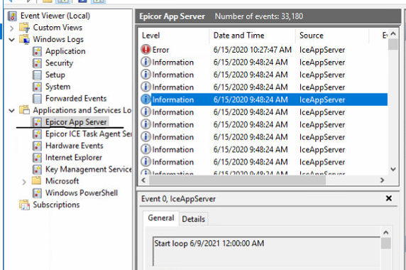

Those events are in the Epicor specific event logs for app or task agent. Up until this weekend mine were also.
I use the logs for debugging and troubleshooting all the time. Below is the post where Bart shows the location.

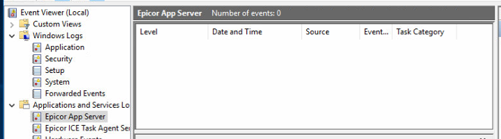

Test/Pilot
Live Epicor App Server is now empty and …
They are now moved to Application
That is weird. What is the oldest event in the Windows\Application log?
(The oldest one you’d expect to be in Apps and Service\Epicor App Server)
