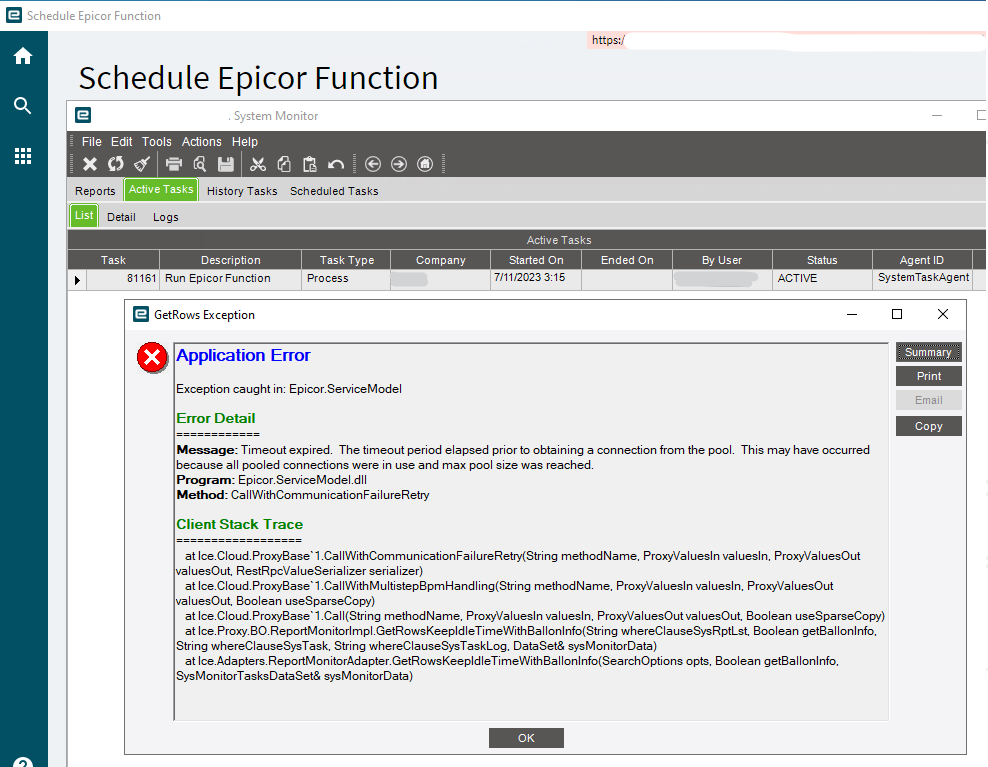

Application Error
Error Detail
Message: Timeout expired. The timeout period elapsed prior to obtaining a connection from the pool.
This may have occurred because all pooled connections were in use and max pool size was reached.
Program: Epicor.ServiceModel.dll
Method: CallWithCommunicationFailureRetry
Client Stack Trace
at Ice.Cloud.ProxyBase1.CallWithCommunicationFailureRetry(String methodName, ProxyValuesIn valuesIn, ProxyValuesOut valuesOut, RestRpcValueSerializer serializer) at Ice.Cloud.ProxyBase1.CallWithMultistepBpmHandling(String methodName, ProxyValuesIn valuesIn, ProxyValuesOut valuesOut, Boolean useSparseCopy)
at Ice.Cloud.ProxyBase`1.Call(String methodName, ProxyValuesIn valuesIn, ProxyValuesOut valuesOut, Boolean useSparseCopy)
at Ice.Proxy.BO.ReportMonitorImpl.GetRowsKeepIdleTimeWithBallonInfo(String whereClauseSysRptLst, Boolean getBallonInfo, String whereClauseSysTask, String whereClauseSysTaskLog, DataSet& sysMonitorData)
at Ice.Adapters.ReportMonitorAdapter.GetRowsKeepIdleTimeWithBallonInfo(SearchOptions opts, Boolean getBallonInfo, SysMonitorTasksDataSet& sysMonitorData)
Executing library ‘LIBRARYID’ function ‘FunctionName’
“AppServerName”:
An error occurred trying to run task ID 81098 for agent “SystemTaskAgent”
on the application server (User: “username”, Task Description: “Run Epicor Function”).

Ice.Common.BusinessObjectException:
Program Ice.Services.Lib.RunTask when executing task 81098 raised an unexpected exception with the following message: RunTask:
System.Data.Entity.Core.EntityException: The underlying provider failed on Open.
—> System.InvalidOperationException: Timeout expired. The timeout period elapsed prior to obtaining a connection from the pool. This may have occurred because all pooled connections were in use and max pool size was reached.
at System.Data.ProviderBase.DbConnectionFactory.TryGetConnection(DbConnection owningConnection, TaskCompletionSource1 retry, DbConnectionOptions userOptions, DbConnectionInternal oldConnection, DbConnectionInternal& connection) at System.Data.ProviderBase.DbConnectionInternal.TryOpenConnectionInternal(DbConnection outerConnection, DbConnectionFactory connectionFactory, TaskCompletionSource1 retry, DbConnectionOptions userOptions)
at System.Data.SqlClient.SqlConnection.TryOpen(TaskCompletionSource1 retry) at System.Data.SqlClient.SqlConnection.Open() at Epicor.Data.Provider.EpiConnection.Open() in C:\_releases\ICE\ICE4.2.200.21\Source\Server\Framework\Epicor.System\Data\EpiProvider2\EpiConnection.cs:line 241 at System.Data.Entity.Infrastructure.Interception.InternalDispatcher1.Dispatch[TTarget,TInterceptionContext](TTarget target, Action2 operation, TInterceptionContext interceptionContext, Action3 executing, Action`3 executed)
at System.Data.Entity.Infrastructure.Interception.DbConnectionDispatcher.Open(DbConnection connection, DbInterceptionContext interceptionContext)
at System.Data.Entity.Core.EntityClient.EntityConnection.Open()
— End of inner exception stack trace —

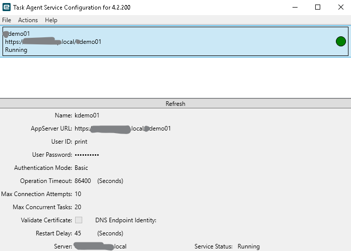

The Task Agent is setup with the defaults:
Operation Timeout is set to 24 hrs

   at Microsoft.Extensions.Internal.ObjectMethodExecutor.<>c__DisplayClass33_0.<WrapVoidMethod>b__0(Object target, Object[] parameters)
   at Microsoft.AspNetCore.Mvc.Infrastructure.ActionMethodExecutor.VoidResultExecutor.Execute(IActionResultTypeMapper mapper, ObjectMethodExecutor executor, Object controller, Object[] arguments)
   at Microsoft.AspNetCore.Mvc.Infrastructure.ControllerActionInvoker.InvokeActionMethodAsync()
   at Microsoft.AspNetCore.Mvc.Infrastructure.ControllerActionInvoker.Next(State& next, Scope& scope, Object& state, Boolean& isCompleted)
   at Microsoft.AspNetCore.Mvc.Infrastructure.ControllerActionInvoker.InvokeNextActionFilterAsync()
   --- End of inner exception stack trace ---
Applications and Services Logs > Epicor ICE Task Agent Service:
"SERVERNAME": Agent "SystemTaskAgent" completed with the following error:
Error details:
   at Ice.Cloud.ProxyBase`1.CallWithCommunicationFailureRetry(String methodName, ProxyValuesIn valuesIn, ProxyValuesOut valuesOut, RestRpcValueSerializer serializer) in C:\_releases\ICE\ICE4.2.200.0\Source\Shared\Framework\Epicor.ServiceModel\Cloud\ProxyBase.cs:line 725
   at Ice.Cloud.ProxyBase`1.CallWithMultistepBpmHandling(String methodName, ProxyValuesIn valuesIn, ProxyValuesOut valuesOut, Boolean useSparseCopy) in C:\_releases\ICE\ICE4.2.200.0\Source\Shared\Framework\Epicor.ServiceModel\Cloud\ProxyBase.cs:line 670
   at Ice.Cloud.ProxyBase`1.Call(String methodName, ProxyValuesIn valuesIn, ProxyValuesOut valuesOut, Boolean useSparseCopy) in C:\_releases\ICE\ICE4.2.200.0\Source\Shared\Framework\Epicor.ServiceModel\Cloud\ProxyBase.cs:line 649
   at Ice.Proxy.BO.SysAgentImpl.GetByIdForTaskAgent(String agentID, Boolean firstPass) in C:\_releases\ICE\ICE4.2.200.0\Source\Shared\Contracts\BO\SysAgent\SysAgentProxy.cs:line 65
   at Ice.TaskAgentCore.ImplCaller.ImplCaller`1.Call[TResult](Func`2 doWork, ExceptionBehavior communicationExceptionBehavior, ExceptionBehavior timeoutExceptionBehavior)
   at Ice.TaskAgentCore.ScheduledTaskRunner.QueryAndQueueAvailableSchedules()
   at Ice.TaskAgentCore.ScheduledTaskRunner.Process()
   at Ice.TaskAgentCore.SequentialAsyncActionRunner.HandleContinuation(Task task, Action action, Action cancelAction, Action`1 exceptionAction)
   at Ice.TaskAgentCore.SequentialAsyncActionRunner.<>c__DisplayClass12_0.<RunAfterDelay>b__0(Task task)
   at System.Threading.Tasks.Task.Execute()
"SERVERNAME": An error occurred trying to call RunSystemProcess on the application server.
Error details:
Ice.Common.EpicorServerException: The underlying provider failed on Open.
   at Ice.Proxy.Lib.RunTaskImpl.RunSystemTasks() in C:\_releases\ICE\ICE4.2.200.0\Source\Shared\Contracts\Lib\RunTask\RunTaskProxy.cs:line 49
   at Ice.TaskAgentCore.ImplCaller.RunTaskImplCaller`1.<>c__DisplayClass4_0.<Call>b__0(TImpl impl)
   at Ice.TaskAgentCore.ImplCaller.RunTaskImplCaller`1.Call[TResult](Func`2 doWork, ExceptionBehavior communicationExceptionBehavior, ExceptionBehavior timeoutExceptionBehavior, Boolean isContinuousProcessingTask)
   at Ice.TaskAgentCore.ImplCaller.RunTaskImplCaller`1.Call(Action`1 doWork, ExceptionBehavior communicationExceptionBehavior, ExceptionBehavior timeoutExceptionBehavior, Boolean isContinuousProcessingTask)
   at Ice.TaskAgentCore.ServiceCaller.RunTask_RunSystemTasks(ExceptionBehavior communicationExceptionBehavior, ExceptionBehavior timeoutExceptionBehavior)
   at Ice.TaskAgentCore.SystemTaskRunner.Process()
"SERVERNAME": Following error occurred while purging SysTask records:
Error details:
   at Ice.Proxy.BO.SysAgentImpl.PurgeTaskHistory(Nullable`1 purgeDate) in C:\_releases\ICE\ICE4.2.200.0\Source\Shared\Contracts\BO\SysAgent\SysAgentProxy.cs:line 83
   at Ice.TaskAgentCore.ServiceCaller.<>c__DisplayClass40_0.<SysAgent_PurgeTaskHistory>b__0(SysAgentImpl impl)
   at Ice.TaskAgentCore.ImplCaller.ImplCaller`1.<>c__DisplayClass4_0.<Call>b__0(TImpl impl)
   at Ice.TaskAgentCore.ImplCaller.ImplCaller`1.Call(Action`1 doWork, ExceptionBehavior communicationExceptionBehavior, ExceptionBehavior timeoutExceptionBehavior)
   at Ice.TaskAgentCore.ServiceCaller.SysAgent_PurgeTaskHistory(DateTime purgeDate, ExceptionBehavior communicationExceptionBehavior, ExceptionBehavior timeoutExceptionBehavior)
   at Ice.TaskAgentCore.TaskHistoryPurgeRunner.Process()
Error details:
"SERVERNAME": The following error occurred while purging reports:
Error details:
   at Ice.Proxy.BO.SysAgentImpl.PurgeReports(Nullable`1 purgeDate) in C:\_releases\ICE\ICE4.2.200.0\Source\Shared\Contracts\BO\SysAgent\SysAgentProxy.cs:line 90
   at Ice.TaskAgentCore.ServiceCaller.<>c__DisplayClass39_0.<SysAgent_PurgeReports>b__0(SysAgentImpl impl)
   at Ice.TaskAgentCore.ServiceCaller.SysAgent_PurgeReports(DateTime purgeDate, ExceptionBehavior communicationExceptionBehavior, ExceptionBehavior timeoutExceptionBehavior)
   at Ice.TaskAgentCore.ReportPurgeRunner.Process()
Error details:
You have the same error in different places… Looks like a pool starvation to me. Maybe your server is just busy and connection pool size is reached?
Thanks Olga. That is probably the case, but if before or after getting this error, I run the client and make the BPM trigger the same Epicor Function, it runs without a problem (it blocks the client UI), but does not throws any timeout. If the function is called from the BPM directive it does not exhausts the pool.
try to use something like sp_whoisactive to figure out what is going on SQL server in both cases.
@carlosqt I’m going to create a new post, but just tagging this one also to see if it jogs your memory - did you ever solve the weird issue where the Function exhausts the connection pool when run direct but not when called from DD? Cheers.
Hi Mark,
In my case, a customer requested to move a large BPM to an Epicor Function to run it on a schedule. I did that with their BPM custom code almost as-is, however, I had this timeout error when ran through the schedule function process. If the Function was executed via a BPM, it was fine (took long, but ran).
To solve the issue, I had to reimplement the function code more efficiently by removing unnecessary loops and queries from the original version. In fact it was processing 3 types of transactions, so besides improving the code, I also split the function into multiple functions. Smaller sets of data were processed by different scheduled functions. Maybe that can work for you too.
