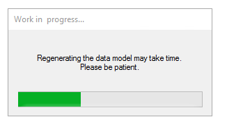

Here I was, 10pm on a Sunday night with the same issue (10.2.300.12) after adding a UD field in Customer… 2 Datamodel regens on the specific app server I’m on (#2 of 3) along with the stop/start of IIS, and table was in sync, but the data model was still NOT in sync.
15 minutes later, the Regenerating Data Model stopped progressing (no, the hidden "data model regen successful pop-under wasn’t there, unfortunately). The green Work In Progress bar kept cycling (10 minutes now, usually takes 3), so I hit cancel, closed and restarted the Epicor Admin Console.
This time the data model regen completed, stopped and started our 3 app pools, but the original issue of table in sync and data model not persisted. Our network admin rebooted the app servers, and all seems well now…
