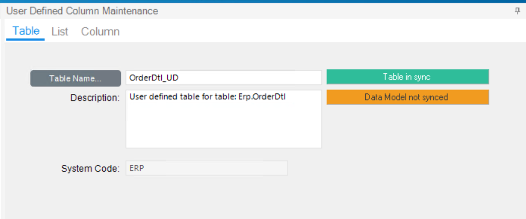

New Kinetic 2022.2 deployment. Data Model regenerates successfully it says but the data model isn’t in sync. Nothing in the DataModelRegen log other than ‘Data Models generated successfully’. Anyone else run into this and have a fix?
It doesn’t work in the demo database either. I added a single field in their demo dB and ran the regen and it’s out of sync. Thought maybe was something with the copy of our prod dB but doesn’t seem to be.

It does correctly updated the view in SQL. But the UD columns are not in the model. Can’t use them anywhere and the UD Column Maintenance says it’s out of sync.
