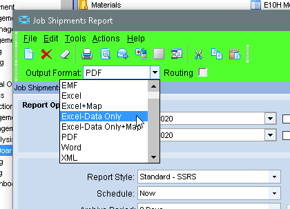

You could make a BAQ Report, and when the user runs it, they select the Excel format.
When laying out the Report RDL, just have a single Tablix, with a column for each field in your BAQ.

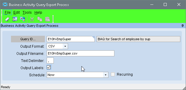

There is also the BAQ Export process. It actually makes CSV files, which Excel can open.

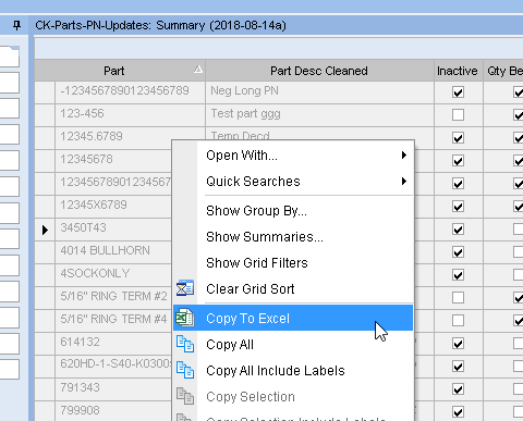

Probably the most straightforward would be to make a Dashboard. If you deploy it, then the user has the option to right click in the grid and choose “Copy to Excel”

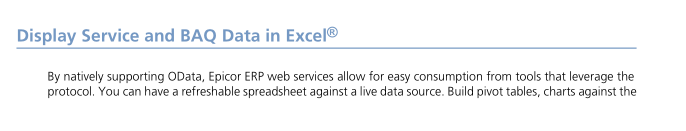

Or pull the BAQ into Excel with oData. The REST services guide has step by step instructions to pull data from a BAQ into Excel. Then you simply press refresh from the data tab in Excel to reload the data.

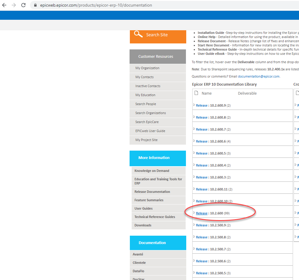

That is exactly what I am looking for in this. How do I get my hands on the REST services guide? I have been told I can see this guide at https://myserver/myinstance/api/help but I don’t have anyone that can tell me what my server name that hosts Epicor is nor the instance name and being a software developer, I am too experienced in these things to determine this myself.
You can find the guide on EpicWeb.
The current version is:
Epicor REST Services v.2

The “BAQ Export Process” module does a pretty good job, easy to use too. You can also schedule the BAQ to run/export with it.

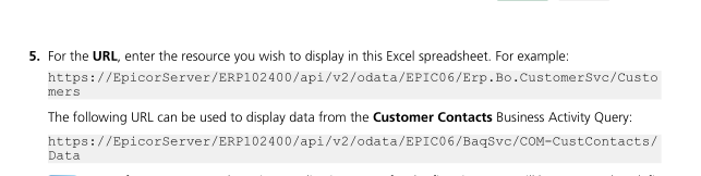

I accessed the REST document and found that REST is enabled in my Epicor. I have a BAQ that I would like to connect to Excel via oData. When I try to use oData in Excel by clicking the following (Data option, Get Data, From Other Sources, From oData Feed) it prompts me for a URL for my BAQ. How do I find out what this URL is? Do I need to create it somehow?

The Epicor REST Services v.2 document has a step by step example of setting it up in excel.
