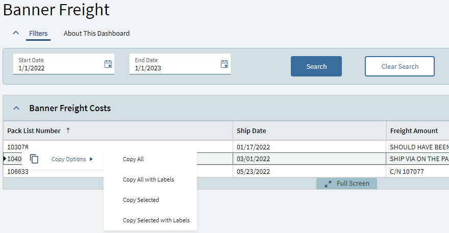

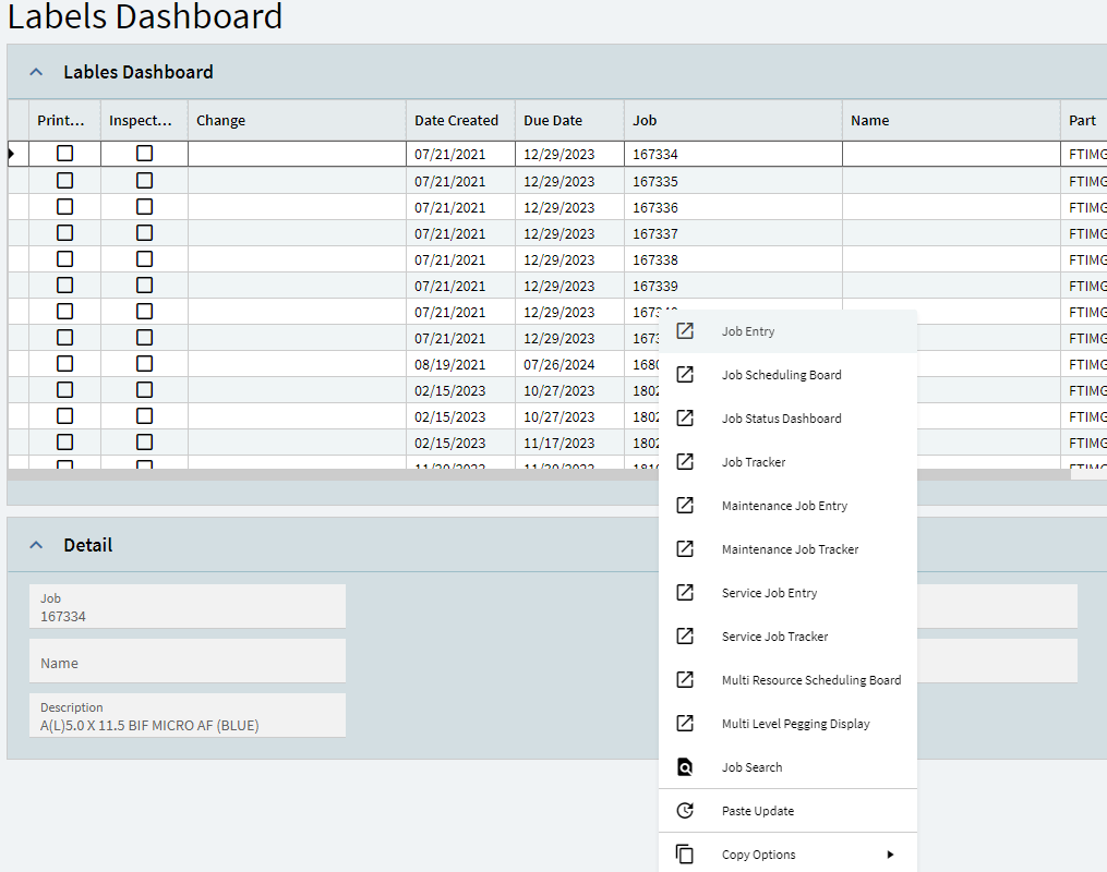

So using your template I was able to create one of our simple dashboards from 10.2, but I noticed the data fields of the grid display do not have standard context menu results. I only see a Copy Options.
If I check a updatable dashboard that I let Epicor re-create the context menu’s exist and I can get to Job Entry, or Part Entry from those respective data columns.
Is there something I missed? or is there a toggle to enable this on the grid view? I know before in 10.2 in order to allow a export to Excel you needed to Deploy the dashboard and runtime’s didn’t allow that function, only copy with headers.

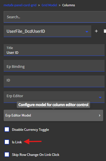

Under Grid Model > Columns, check the Is Link box for the columns you want linked.

So I tried this and unfortunately it did not work. The column is now underlined “link” text, and when clicked on it does nothing. I feel like it doesn’t know what to open or what those numbers represent. In 10.2 the right click menu gives me the option of Open With. Do I need to create a context menu item for this dashboard separately and point it to the proper application? The BAQ is referencing a Memo table in this scenario that is linked to a Ship Head table, so perhaps I’m using the wrong column from the BAQ to get the result I’m looking for. I’m noticing our current 10.2 Dashboard is built differently and has changed since I did our 2024 conversion test. The column that has a working right click is the Ship Head Pack ID column, where in Kinetic its the Memo_Key1 field.
Original dashboard in 10.2
Scratch my question… Yes it’s because that specific dashboard was pointing to a Memo_Key1 field. Once I replaced that column with the actual Pack ID from the Ship Head table I now have a working context menu. I have to assume if I turn it into a “Link” column then they don’t even have to right click, they can just click on the number to get there.
