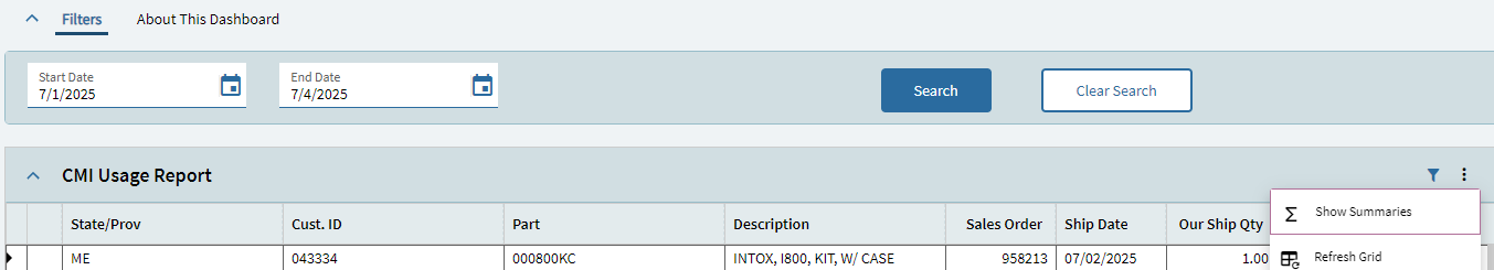

When I run it, select a start date and end date, click the ‘Search’ button, I get semi-random list in the grid at the bottom.
The thing is, if I click the three dots and select ‘Refresh Grid’, it populates with the correct data!

Then I went over it very carefully and wondered what would happen if I unchecked the ‘Server Paging’ box for the grid.
Once I ran it, it worked as expected!

Glad you figured it out! I only turn on Server Paging when there are a lot of results (at least 1,000). Server paging returns 500 (default) rows at a time. Then you have to click the download icon to get 500 more. When it’s turned off, results are virtualized, loading more as you scroll.

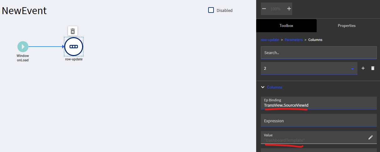

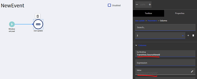

Create a new event and set the SourceViewId and SourceViewName as follows:
Thank you!
That worked for me.
