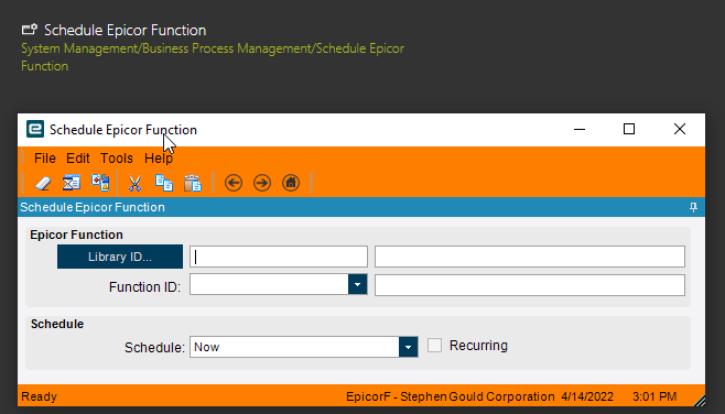

There is also a function scheduler right in Epicor now.
