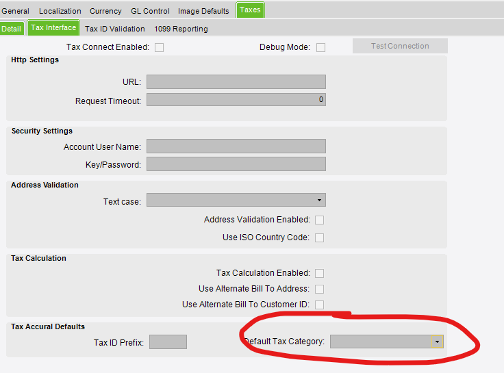

There’s a Default Tax Category in Company Config. All Modules → Taxes → Tax Interface
I am about to clear all those out at go live in a couple weeks when we switch to kinetic and to avalara. Going to need to clear it on all the open orders
@TomAlexander - Hmmm. Nothing specified here… any other ideas?

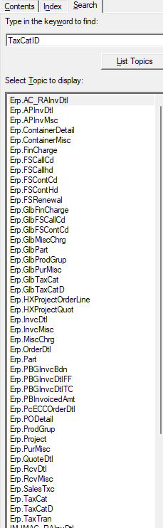

Here’s a list of tables that come up in @hkeric.wci 's 2022 CHM when I search for TaxCatID. Not sure if these will lead us anywhere.
Look at some of those base tables like Part, Project, ProdGrup

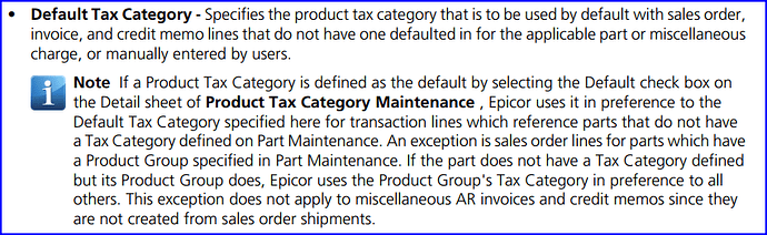

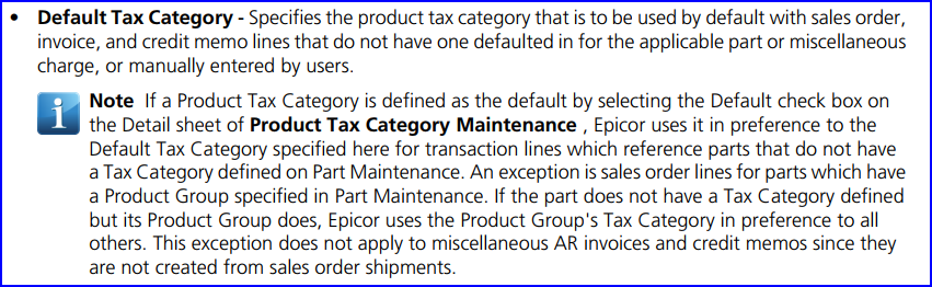

scott what reference guide did you drum that up from?

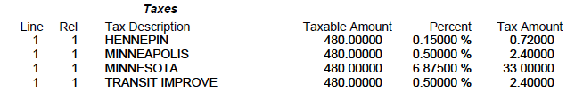

I think we were in like 7 or 8 states prior to this. From the orders I’ve put in to test I’ve already seen some silly tax structures that I am glad I didn’t have to try to keep track of. Here’s an example of an order written in Minnesota…
If it pleases the court…
Epicor Tax Connect Configuration Guide 10.2.200, page 8, step 9, bullet 2! :smirk:
I thought so man, it looked ooooollllllld.
