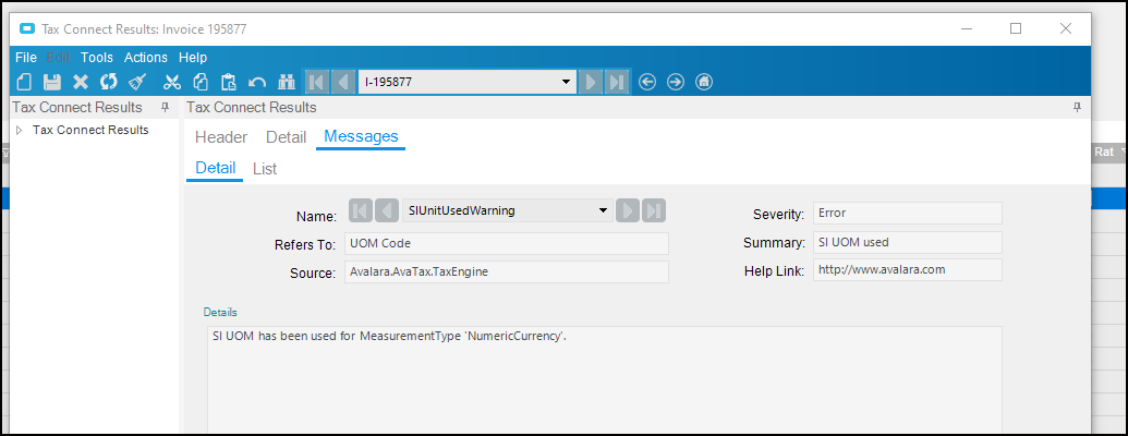

I have checked the Sales Order, the Pack Slip, the Part master, and the Invoice it created to see if I could see an issue with any UOM but to no avail.
Has anyone seen this error before? The four invoices in question have all shipped to Canada and have at least one kit part in the shipment. We do not use multi-currency but do use Tax Connect, which is where this is failing.

We have received the same messages here, 29 related to quotes and 2 related to invoices. For anyone who may be interested, I’ve attached a BAQ for the TaxSvcMessages and related tables. FSIP-TaxSvcMessages.baq (27.7 KB)
It currently appears as though this Avalara error message occurs for only transactions which have Canadian addresses on their lines; the error has yet to occur in testing here with US addresses. If you receive the error when trying to process transactions with US addresses on their lines, please let me know.
