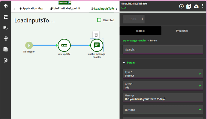

Then I added a slide-out message for debugging, and lo and behold, that is the key to solving my problems!

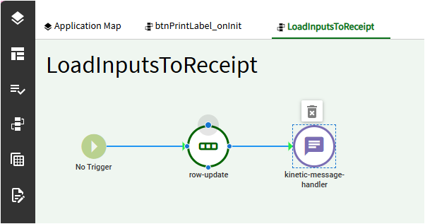

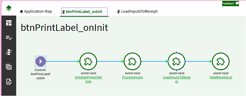

So here’s the main event (no pun intended) that runs when the form opens.
And one of those has a “message handler” in it.

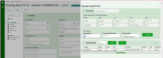

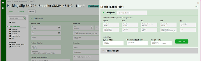

Now I’ll go to the different app that calls this one (as an app-open slideout) and my message also slides out. All normal stuff so far.
Once I click OK on the message, the panel card grid is disabled. Again, all good.

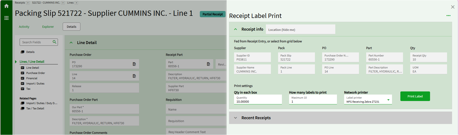

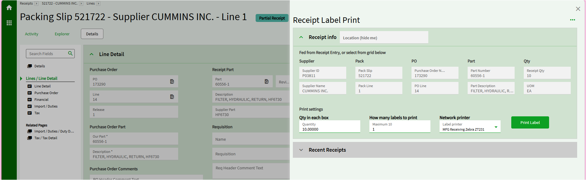

BUT - if I delete the message from the event and re-publish, the panel card grid never gets disabled. (Compare pic above to pic below.)

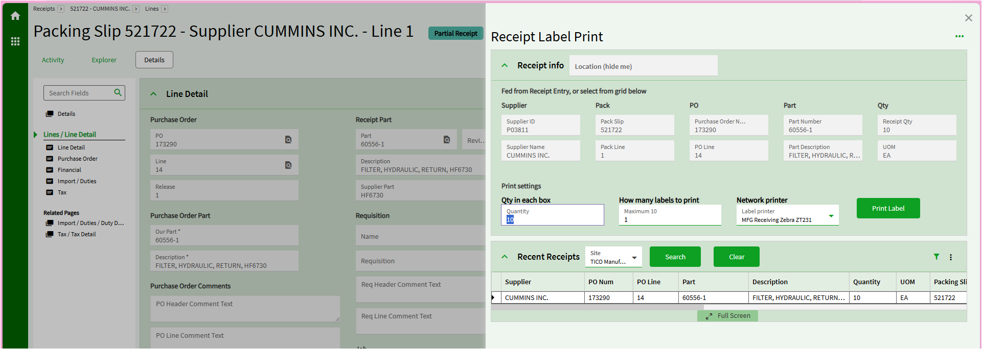

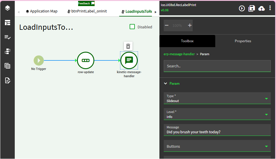

I’ll add a message back (and republish)…
And it’s behaving again.
FYI, the only “Type” of message that did this magic was the “slideout” - not the toast or alert.
In conclusion: the message handler can fix problems in App Studio.

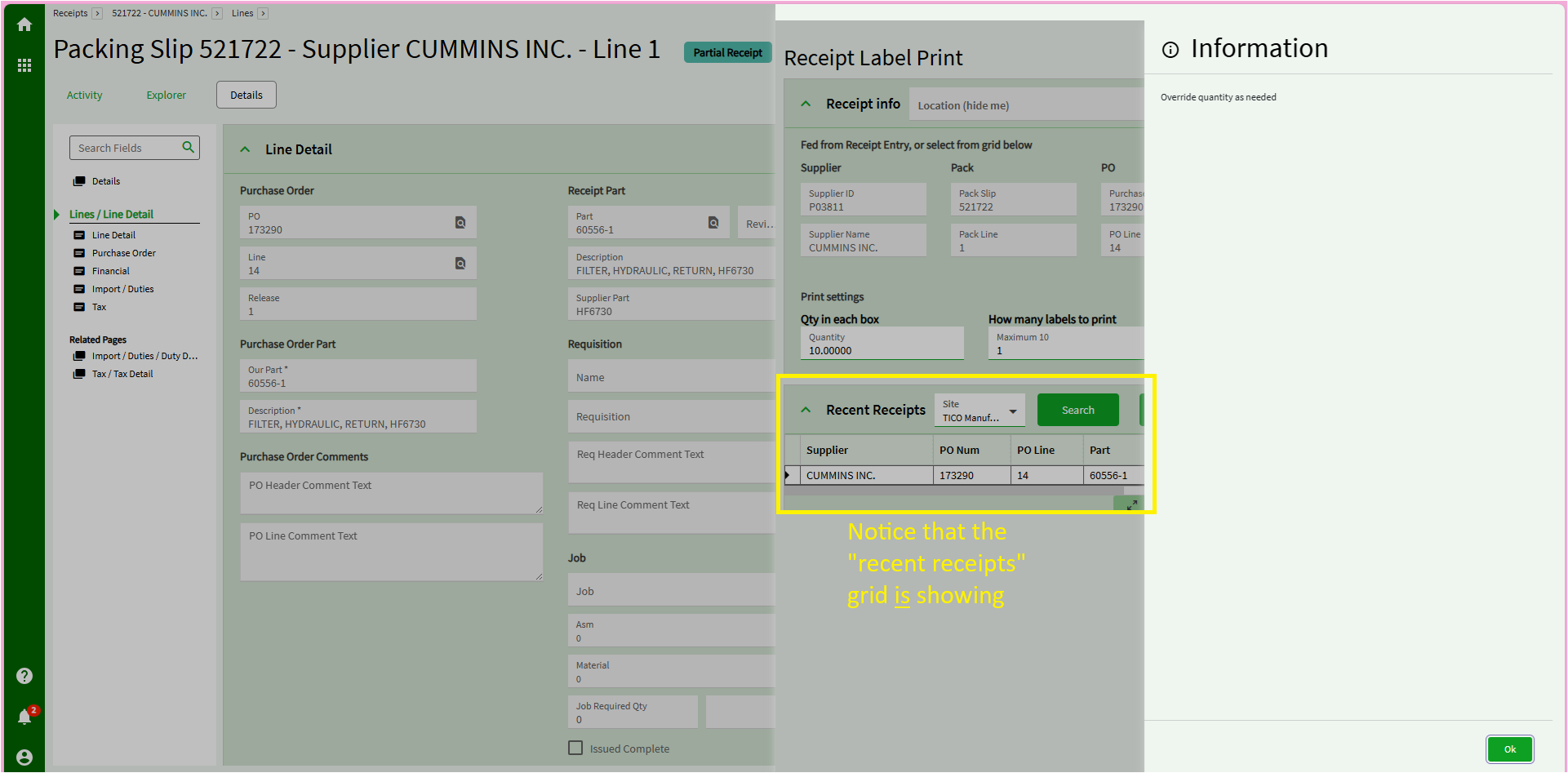

I had tested putting the message in different spots.
  • If I put it at the beginning, the panel card grid NEVER looks enabled and you cannot see its contents (which is what I would prefer).
  • But in the pictures, with it in the middle of the flow, you get this - where the grid shows before the “OK” button is clicked, and then it disables.

Hide is firing before LoadInputs finishes. Try linking to Success of LoadInputs:
I’ll try now…
So, backstory: each of those mini-events has just a single action (row-update or property-set), and I used to have them NOT in their own events, and I tried the “Success” arrows, but that kept bombing. Tried Conditions also.

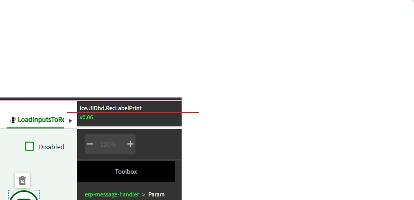

It may help to know the context, which is the loading input data from the app-open (these screenshots are from the app that gets opened). I feel like there is some major voodoo there.
What is the app being opened? My RcvLabel form doesn’t look like the one in your image. Or did you customize it?
gotcha… custom dashboard. No wonder I couldn’t find it :rofl:
