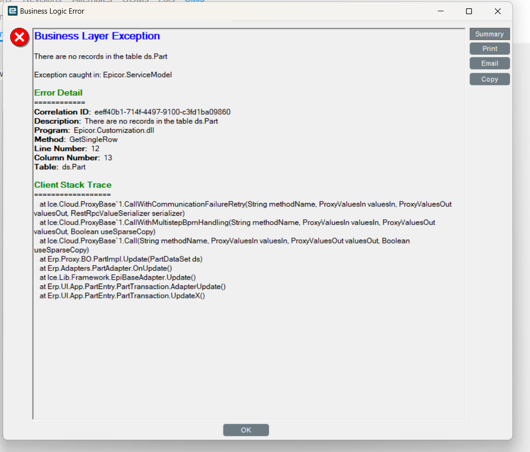

Updating primary bin in pilot and I keep getting this error. “There are no records in the table ds.Part”
To my knowledge all the BPMs are disabled.
All of a sudden started doing it. Does it for every part. Not sure what the cause could even be.

I take any part in pilot. I can update the part, description, pricing, etc. But when I get to the warehouse tab, that is when I get the error. This is only when I change something and I try to save it.
In this case, when I set the primary bin or change it, it’s popping this error. Works fine in production.
It just started today out of no where. Changed nothing. No new BPMs. In fact all BPMs are turned off.

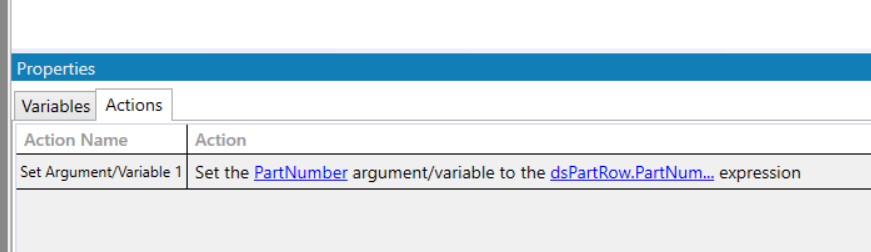

I’m setting a variable “PartNumber” and I use the “Set Argument/Variable” widget. The “Set Argument/Variable” is the problem. I remove that and I get no error.
Here is the simple BPM:
Here is the Set Argument/Variable widget.
It’s only job is set variable PartNumber to dsPartRow.PartNum.
Shouldn’t be an issue but for some reason it doesn’t work. I tried it in pre-processing and post-processing.
Solution was to go another route on the expression.
I used dsPartWhseRow.PartNum instead and no issue.
