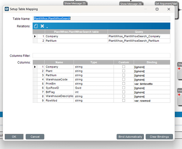

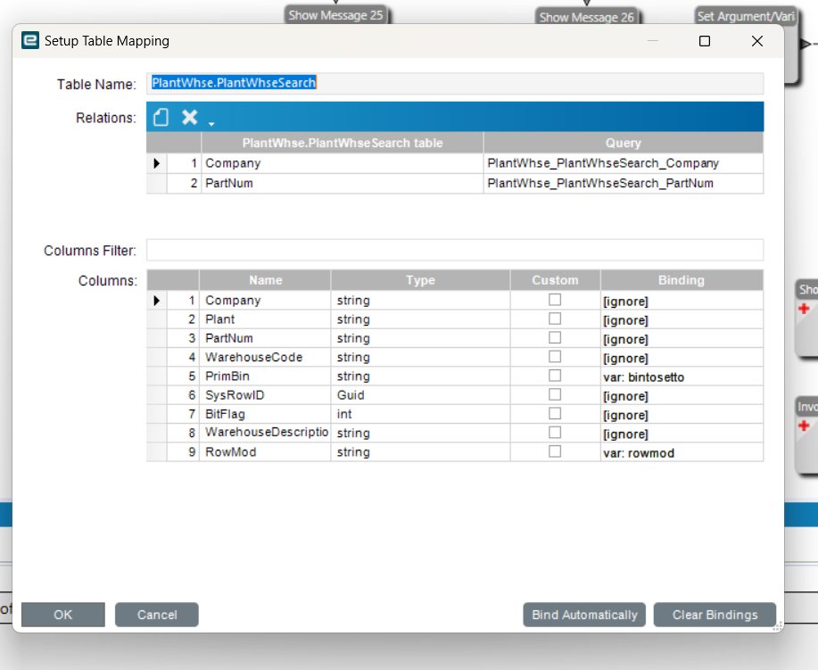

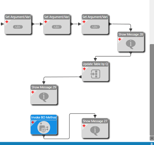

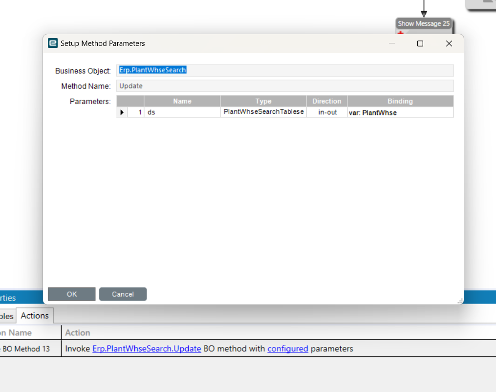

I pull down the PlantWhse data with a BO. Set the dataset.
Then set the variables for the things I want to change
Update the table using the variables

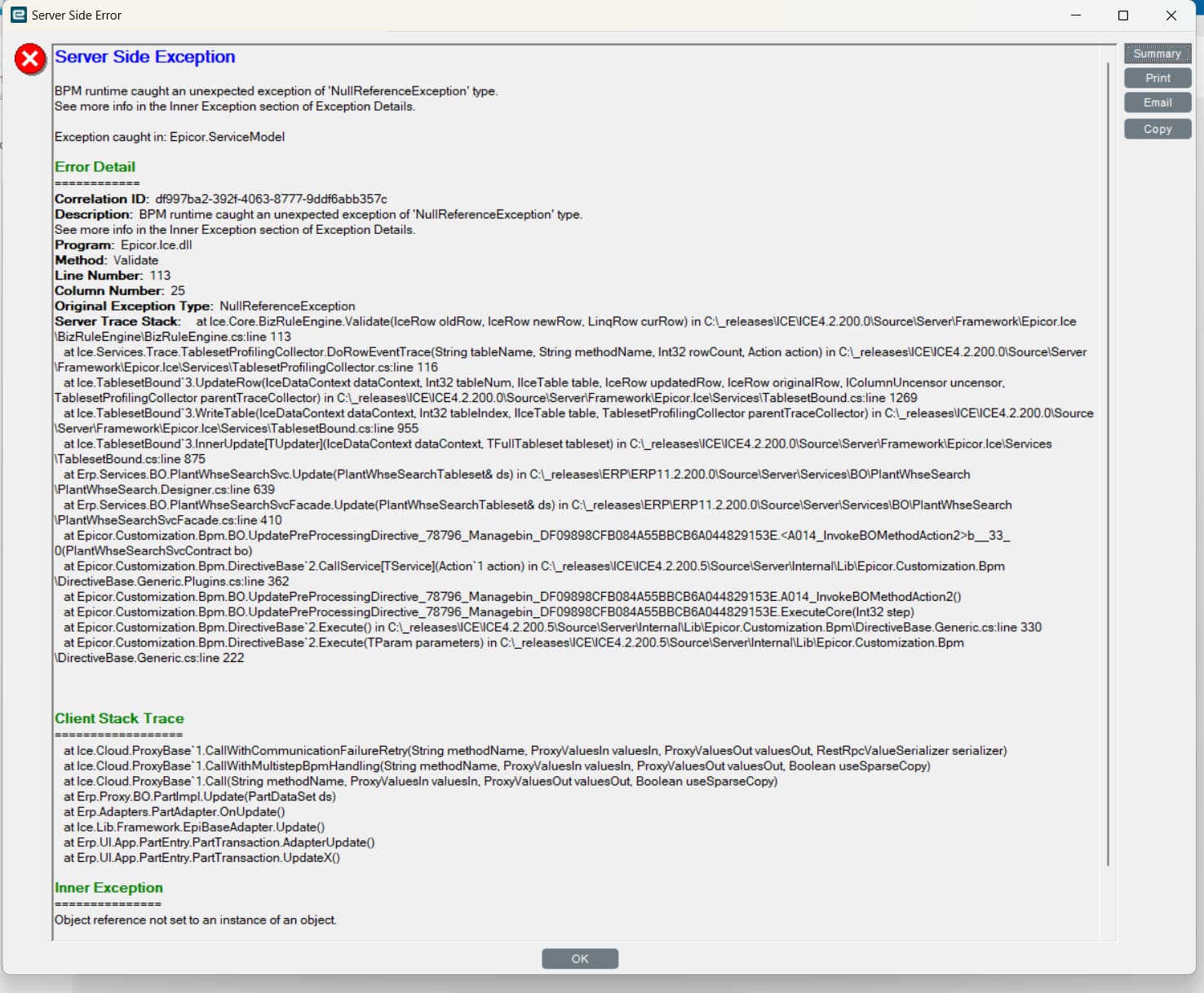

Then I attempt to run the BO method for PlantWhse update and I get a Null Exception error.
Unsure it matters but PlantWhse only comes up as PlantWhseSearch.
I disconnected the final BO because it will error out with the Null Exception if I don’t.

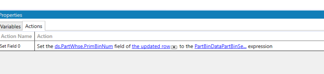

I did try to change the bin when it is set based on Part.Update. Still didn’t work. Granted I used the Set field widget/object. I tried both PartWhse and PlantWhse. Neither worked.

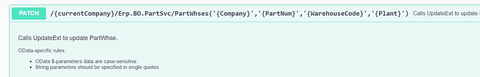

I went over to the REST API portal and tested some of the different endpoints out.
What I found is PartWhses was the one that actually updated the bin. Not PlantWhse or anything else. I should note that, using PlantWhse and others I tried, kept coming up with a error 400.
