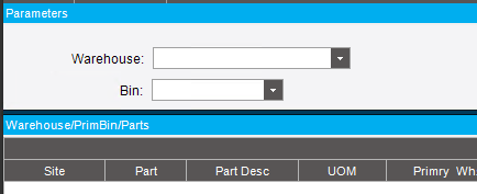

Now that the BAQ is done, create the dashboard and just put in a grid view. Deploy the dashboard. Open up the dashboard in Developer Mode. Add in a sheet and whatever tool is needed to select the filters. I used two dropdowns.
Bind the fields to CallContextBPM fields. Now, go to Method Directives and put a Pre-Processing BPM on Ice.DynamicQuery.Execute. A condition can be put on it to call out the specific Query. Then I entered the custom code.

Now, when you run the dashboard with the refresh button, you will send specific filters to the query without any Parameter box pop up.
